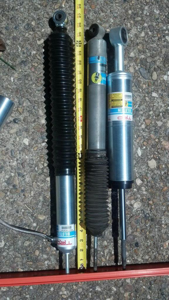

    So from what I read so far the OME nitrocharger shocks limit the articulation of the Dakars and its better to go with Bilstein 5100/5160's for rear shocks? Since its nitrogen I assume the OME shocks are stiffer then the 5100's correct me if iim wrong

    Not enough
    5160's are too short! ask me how I know:rolleyes:

    First heard for me. Pretty sure it's been stated in this thread already, many times, that the nitrochargers are longer than the standard 5100s and the 5160s. The exented 5100s are too long and you end up needing bigger bump stops which limit travel. I fail to see the benefit to Bilsteins over the OME shocks that are built to go with the Dakars.

    2012 Red Baja
    My 5160's are 27" tip to tip. Mine came with my truck though.

    The shorter Dakar leaf pack on my 97 reg cab has about 1" more droop than the ome nitrochargers allow. After 5 or so hard wheeling trips, the shocks are toast. I ordered 5125s from downsouth motorsports to replace them.

    no offence but...
    http://www.kyb.com/parts/measure.php
    They look to be about 25" extended. Still a 1"+ short for full droop of Dakars

    No offense taken I didn't say extended length I said "tip to tip" because I wasn't sure where to actually measure for proper extended length.
    What is the full droop of Dakars?
    Edit: From what I found the "Tacoma" 5160s only have a 23" extended length according to bilstein. However there appear to be quite a few versions of these on the internet. Where did you order the ones you had come from?
    This is from bilsteins website.
    http://www.bilsteinus.com/uploads/tx_templavoila/5160flyer_6.23.11.pdf

    The Bilstien 5160s measure 23.8” extended length per Bilstien, they list the specs on their website. The ones you have in the pic look longer and maybe because they are built this way specifically for Toyota and the Baja package.
    The OME rear shocks (60091) measure 24" extended length and collapse is about the same as the 5160s, I've measured them before and took the plastic boot off to get an accurate measurement.
    Compression of the OME shocks also feels softer over the Bilstiens, more so over the extended ones (RCD 5100s) which are actually quite firm.

    So I literally just went and lifted my truck up with our forklift as high as I could before I lifted the back tire and measured the shock.
    From the center bolt on the bottom to the center of the rubber bushing on top was at 25.XX". I am not totally sure the shock is the limiting factor or if my stock leaf springs are. Either way I believe they are long enough. I will do the same test once my new setup is installed in a couple weeks.
    I didn't take a picture, but here is one from the other day doing the same thing. lol
