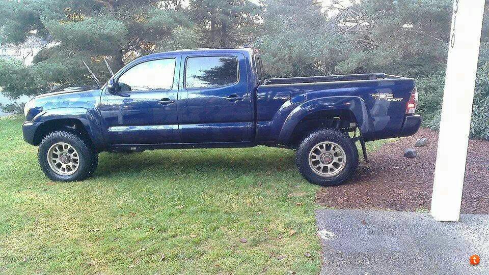

    Yeah budddddy you made my day! Guess I am ready to go then. So this will sit level correct? I saw you comment on a guy in an earlier post where his ass end was so high it didn't even look like the front lift was on lol
    this guy
    I want level….

    You're not going to be level

    ok so what do I need to do to be level. Top plate spacers?
    your truck looks pretty level in your pics…..how do I be like you?

    Well , 885's will lift you 2 1/2" and Dakars will lift you 2 3/4" or so , so essentially you will have slightly more than factory rake

    I have 1 1/2" of rake

    so if I add a 1/4 top plate spacer I should be closer to level correct? or am I way off?

    That would get you pretty close , more level than my truck is

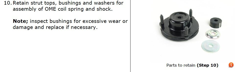

    What about 'Assemble front shocks/coils with new bushings' what is this option? Its on the Toytec website and I haven't seen anyone else ask about them?

    It just means they will put the coils on the shocks for you and add new bushings instead of how they normally come. Normally they would come separate and you would have to rent a coil compressor or have a shop compress the coils and put them in the shock for you while using the bushings off your old setup.
    That is how I understand it

    Ok I found some instructions and I think this is what they're talking about. Guess it wouldn't hurt to change out these parts. una3egep_9513826b0521a8eb7ff2a20f0dfac7df71fb83ba.jpg

    I would have them assemble for $100. I tried to save money and do it myself, not realizing I had to buy the top mounts also. Spent $60-$70 on them, and had to look around for awhile to find a shop that didn't want to charge me $100 to assemble. Found one for $50. Plus they will set you up with extended studs capable of fitting top spacers. Plus they come bolt on ready, no hassles. All in all, I spent well over $100 to assemble them. Totally worth it to pay Toytec, IMHO.
    You could try the floor jack method, but I have heard it is difficult with the spring rate of 885s, (near) impossible with 886s. Good luck, I'm stoked with my OME setup!
