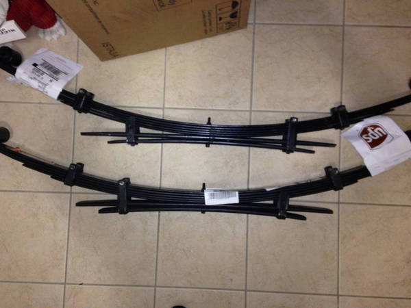

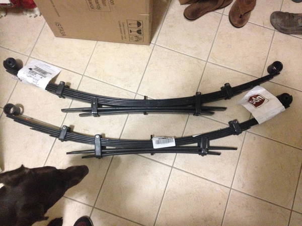

    am I good to go? Anything look out of the ordinary for my new set of Dakars?

    Did you get an extra set of bushings and new u-bolts? Springs look fine. Did you get a plus and a minus set?

    I assume the new unbolts will be coming with the springs and shocks later. Unless I am clueless I think the new bushings are already in the springs…there is one side with bushings and one side with nothing.
    My sets have one with a + and an arrow and the other has a - and an arrow ( I haven't read what that means yet)

    Exterior: -Current Suspension- Icon extended travel front struts w/ 700lb coils Icon extended travel Remote Resi rear shocks Dakar leaf pack Icon Tubular UCAs with covers Icon neoprene shock covers -OEM Roof Rack -2 fold down cup holders in bed -Bed bottle opener -Access lite rider roll up tonneau cover -AFE Prodry air filter -Pop and lock bed lock -Rear differential breather relocation mod (behind tail light) -Aeroturbine 2525XL Muffler Armor: -SOS Concepts bolt on sliders W/ kick out -SOS Concepts aluminum front bumper with full hoops -SOS Concepts Rear HC Bumper -SOS Concepts IFS/Mid skids
    So what would matching be?
    And
    I have one with a + and one with a -
    Is something wrong with that or am I good.
    Does one go on a different side etc

    Does it matter which end goes
    Forward? The symbols or blank ends?
    Just looked at my order and the rear bushings are coming. Great!

    The end with the bushing already pressed in goes towards the front of the truck.
