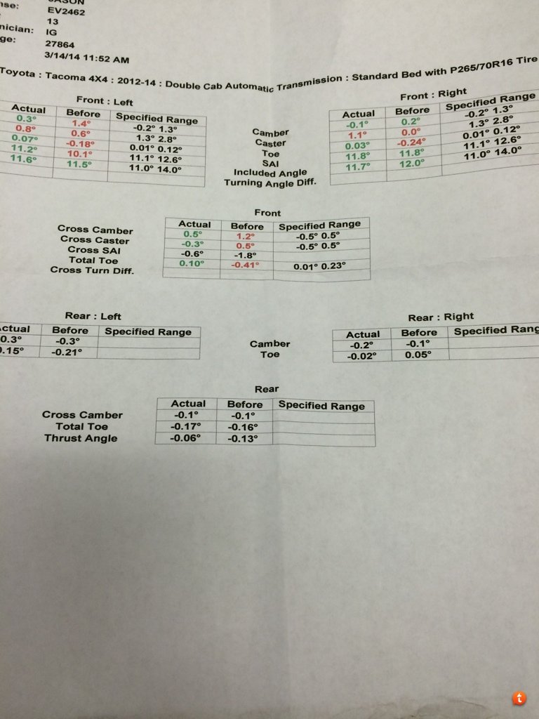

    Can anyone tell me if these are good alignment numbers??? Also it took me and a friend 3 hours start to finish...u7a8u7eg_e0edf85118d1b133b460f4d5bfd7877e375eb9f6.jpg

    Can anyone tell me if these are good alignment numbers??? Also it took me and a friend 3 hours start to finish...u8ume2ed_648b0869edc5a1df5b6457719b0685882bd7f85c.jpg

    They are not

    It's that bad to prematurely wear my brand new tires?

    The camber doesn't seem too bad , just really low caster , did you not get UCA's ?
