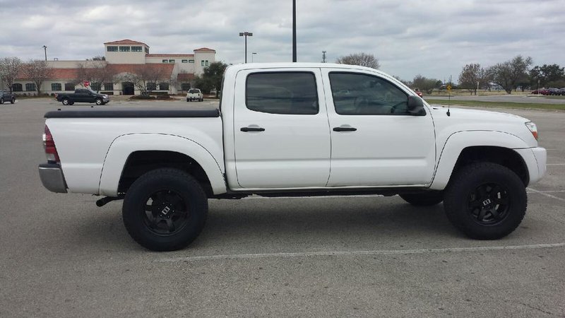

    Update on mine because I know you guys were worried sick...it didn't come up the 4 inches I initially overreacted to, but it did come up 3 1/4 with just the 885s and no spacer. Had the alignment done yesterday and it spec'd out fine. No vibes except for the very smallest at takeoff; which is liveable. But I'll ask again, can I expect the front to come down after a while?
    Thanks

    [FONT=&quot]
    Here's a pic
    [/FONT]

    You don't have as much weight up front as a 4x4 so don't expect the ride to improve much if its stiff nor it to come down much. Also at 4" your arms have to be facing the ground pretty good and without UCAs (not sure if you have them) I couldn't imagine your alignment is any good. If I were you I would have pulled the trigger on lift spindles. Way better quality of ride, arms remain almost flat just like stock so no need for UCAs at all and the best part is you maintain the same available down and up travel as stock so over the bumps this makes for a lot better ride.
    Prerunner = spindle lift
    4x4 = stuck lifting with stiffer and or longer coils
    Maybe not what you wanted to hear, but maybe useful info in case you start to hate on those 885s.

    Looks level as can be to me and don't look like 4" :confused:

    Thanks for the reply. Actually it only came up 3 1/4 I didn't measure correctly. Ride quality is great and alignment went well. I think I was just used to the rake before so it was weird seeing it level.

    What's the hub to fender measurement and post a pic of the coil assembly
