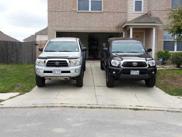

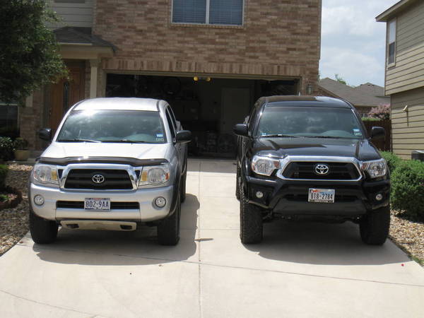

    Helped a buddy install a full OME kit on his 2005 TRD Off-road today. He skipped on the UCAs for now so we installed dakars and nitrocharger sports in the rear and 885s w/ 1/2" spacers on nitrocharger sports in the front. Also did the diff drop even though I tried to talk him out of it. I can see why it's pretty much pointless now that I've put one on. Being in Texas, none of the bolts were seized so it was pretty painless. Helps we had practice on my truck last year. About 5 hours with breaks for everything. Now it's time for some beer!
    Our trucks side by before, mine's clearly higher:
    Side by side after, about the same now:

    I only took the one pic, wasn't my truck. After only minimal driving his is about an inch taller in front than mine is with 1/4" spacers and about 15,000 miles on the lift.

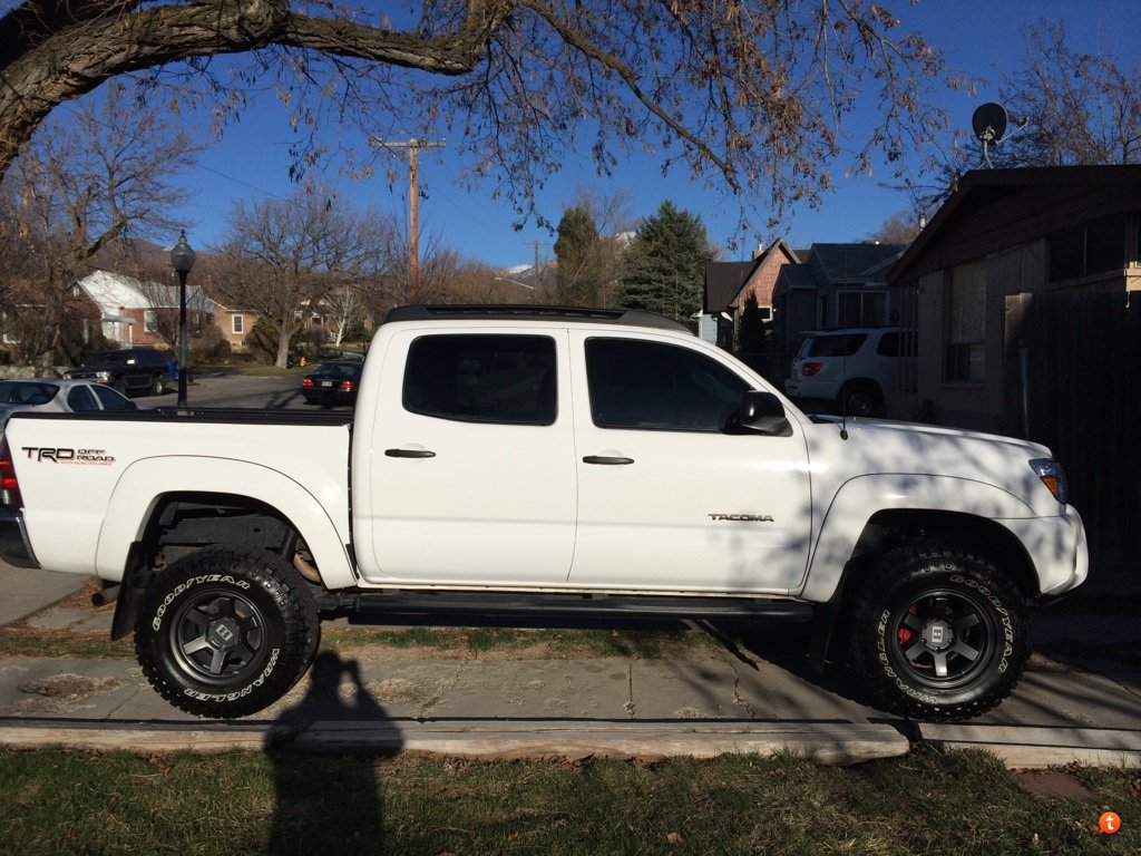

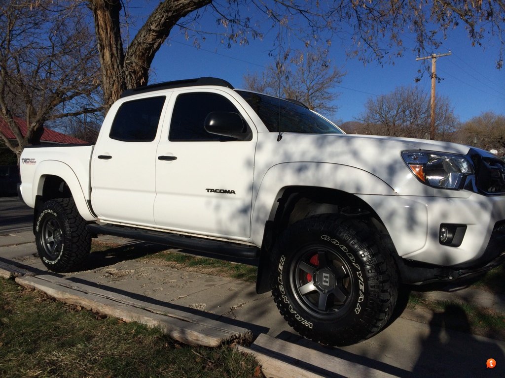

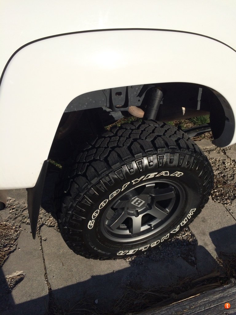

    Here are some better shots of new lift me and a buddy installed
    byha3u3u_b9f84fb4cdea703b583c194e73e6afde3bc8847d.jpga6edu2a9_933586a322244c4ae102c4066ed55a6d25b34757.jpgemupyqyq_1d709bf9e410b896e2927997221b789c97dce371.jpg
