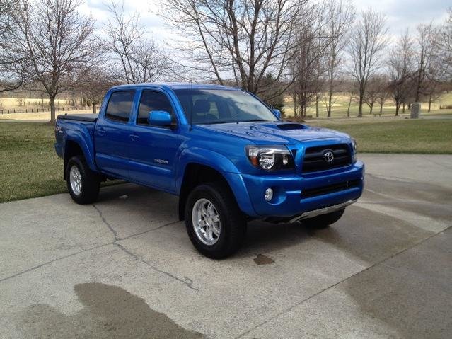

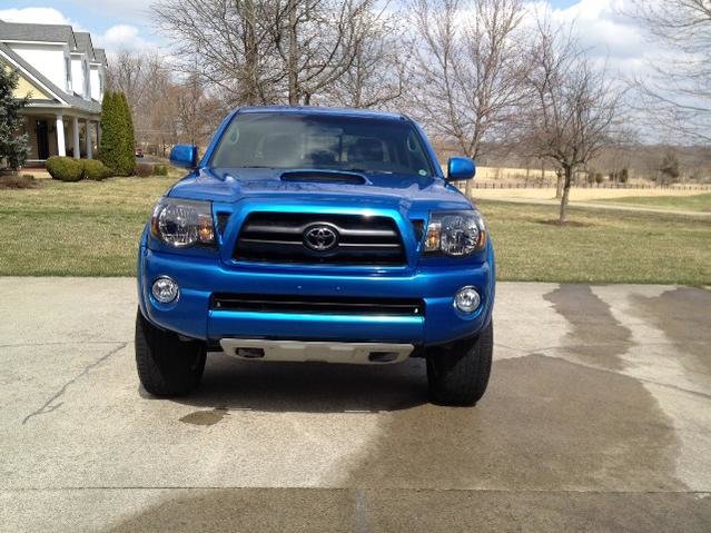

    I don't normally dig on blue Tacos, but the lift and those wheels really set it off!

    Nice, whats the pack in between the rear brake lines.

    Looks like the new u-bolts to me.

    yes I think you are correct. At first I thought maybe shims but then I couldnt figure it out.

    Correct, new U-bolts

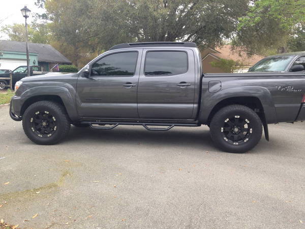

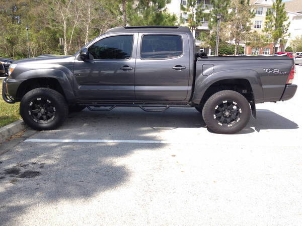

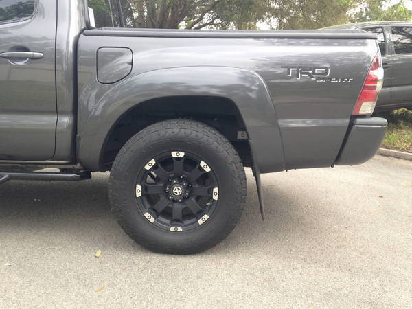

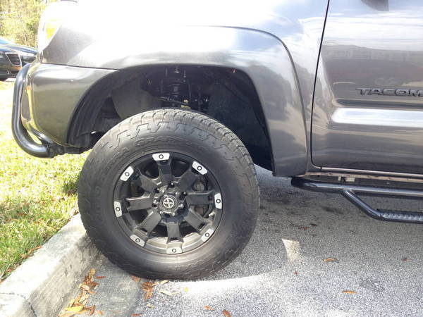

    They are the nicest people to deal with too and will get you sent up right. Head strong all the way. On another note finally got my lift on and it took a lot more time than we had expected (mainly from having to run to the dealer several times for parts, discount auto for tools needed 3 difference times) but it was a great learning experience I just wish there was a list of tools somewhere that would be needed cause there were some sockets that were just a little bigger than I had in my tool kit. (like a 19mm and a 32mm)
    Anyway here are some pics and I will put my measurements on the measurement thread soon. Getting my Duratrac 285/70/17s in the morning so these are my nittos 265/70/17
    Setup:
    Full OME kit: 885 coils, dakars 1/4 top plate spacer, trim packer, LR UCAs.
    Before:
    After:
    Measurements:
    Before:
    Driver Side: Front 20 1/4", Rear 22"
    Pass Side: Front 20 1/2", Rear 22"
    After:
    Driver Side: Front 23 1/2", Rear 24 1/4"
    Pass Side: Front 23 1/2", Rear 24 1/4"

    I just re used the stock ones just drill a small hole in it to accommodate the longer bolt and it is fine. I really don't see a need to buy new ones.
