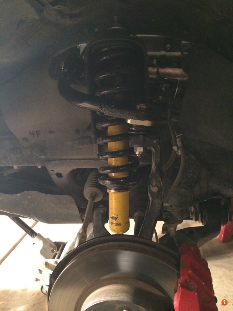

    RIPieces 2005 Tacoma, adios 2011 :'(
    Factory Monster Truck Package with reverse gear.
    etu6arat_b8a0c219791e6137ac0efff2636bf647795e3c36.jpg.
    Completed my OME lift with UCAs it rides so much better with these light racing UCAs

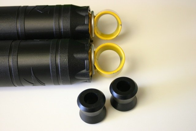

    Anyone got a decent method for pressing the bushings into the eyelets on the rear shocks?
  18. Mar 29, 2014 at 10:06 AM
    #4198
    tomtom
    tomtom Well-Known Member
    Jul 15, 2012
    #82706
    5,371
    The Desert SW
    2012 FJ
    They have an hourglass shape to them. Guess I'm going to have to rent the press or find a vise.

    Hmmm mine came already in there from headstrong offroad.
    I didn't know they came separate otherwise.
    Vaseline it up and c clamp it in would be my first attempt.
