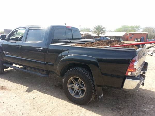

    Biggest test of my Dakars to date. A full yard of soil mix. Handled it like it was nothing. No idea how much it weighed though.
