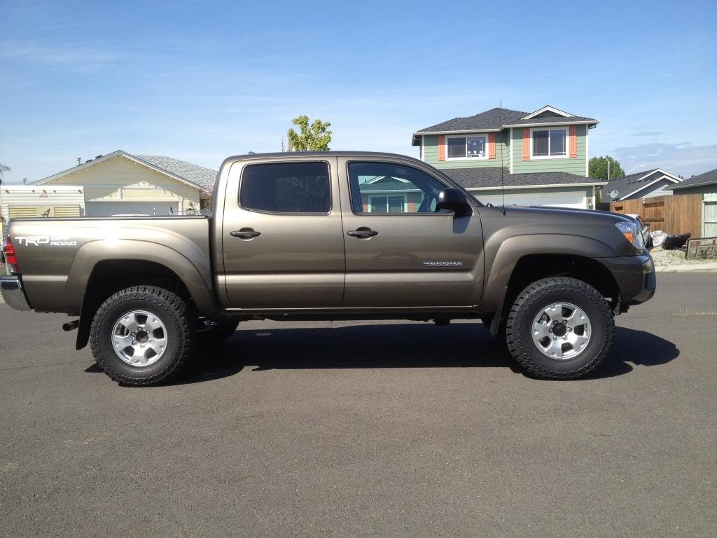

    Here is my truck with the new tires. 265/75/16 Cooper ST MAXX.

    LOOKS GOOD! Tight work. Now enjoy.

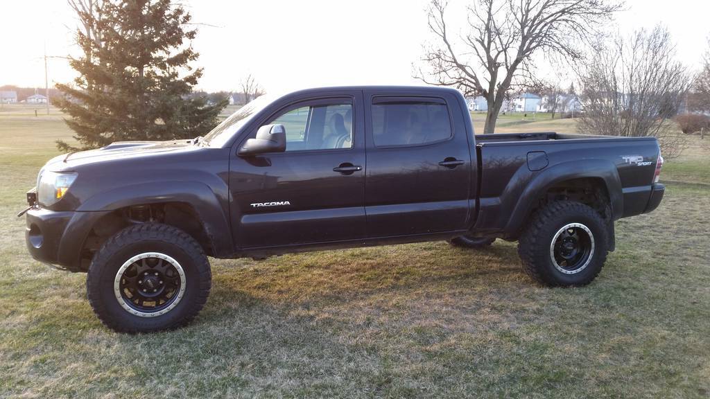

    Here's mine. I got the lift done back in November, but only got the wheels & tires done on Thursday. I am now running a set of BF Goodrich KM2 LT285/70-17 on Ultra Wheel Xtreme 17x8.5. Have some minor rubbing issues but will eventually take care of it (or let my tires take care of it !!!).
    The lift is a 3in OME with 885 front and Dakars ar the rear.
    Now I just found out that my driver side driveaxle up front have a nasty play in it. Anybody remember what was the solution posted about this a while ago? I guess it's about the bearing inside the diff housing.

    Not enough
    ECGS Bushing
    http://eastcoastgearsupply.com/i-8536125-toyota-8-clamshell-bushing.html

    what Mack said. I did the ECGS bushing install when I rebuilt my front end on my double cab. I had no noise and a little slop but did it anyway. it cured the vibration in my access cab.
    and if you need a set of hubs while your in there let me know :thumbsup:
