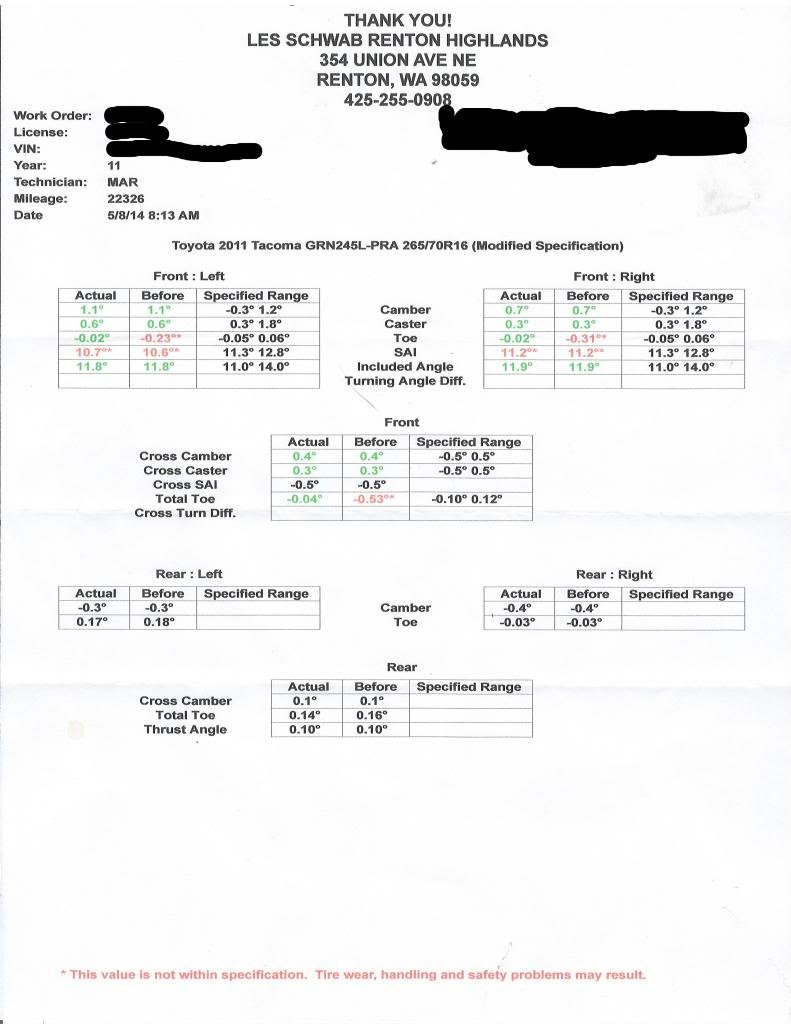

    So, got an "alignment" done at Les Schwab. It is in quotes because the only thing they changed was the Toe! Never even touched the Caster or Camber. Tech just saw "green" figures and called it good. I'm going back tomorrow to have them redo it, although I am actually tempted to go to a completely different shop. I have no idea where Les Schwab got their "modified Specification" numbers from.....

    So yeah, the numbers are in the green according to their spec sheet, but still at the extreme ends (near max positive camber, near minimum caster).
    If anyone understands the relationship between the numbers, if I get the camber closer to zero, what kind of increase in caster am I looking at?

    Camber and Caster works against each other. Can't increase caster without being affecting camber which most likely going to make your tires look like this \----/ without aftermarket UCAs.

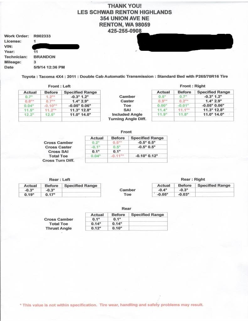

    Yeah, looks like I need some UCAs. Already ordered the Light Racing ones from Headstrong. Here are today's revised numbers......

    much better for having stock ucas. when it says 'modified spec' that means the tech went in to the computer and manually changed what spec is. that causes it to look alot better when comparing actual measurements to"specs". its a hack way to make ur alignment look correct
