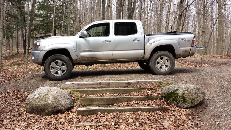

    4 X 4 DCSB 2010 4.0L,
    DF 22 1/4 DR 24 1/4
    PF 22 1/2 PR 24 3/4
    After my 900 mile trip about 250 miles off road and full tank of gas.....
    So they have settled in about a 1/4 of an inch all the way around......
    I was looking for 2 in the front and 3 in the back so i'm happy and the ride and handling is great.... No more bouncing...
    Gravel and dirt roads feel like the hard top at 50.....
    I drove it with the front struts and rear shocks and the stock leafs are just rough riding. When my leafs came in from back order the truck drove alot better. I would reconmend to get the whole kit and remove leafs in the rear to get the height you want and throw out all the stock parts....
    A++ I love them... We were on some very soft, rocky and rough loging trails and never used 4 wheel drive. Get on the highway and it feels like a caddy....
