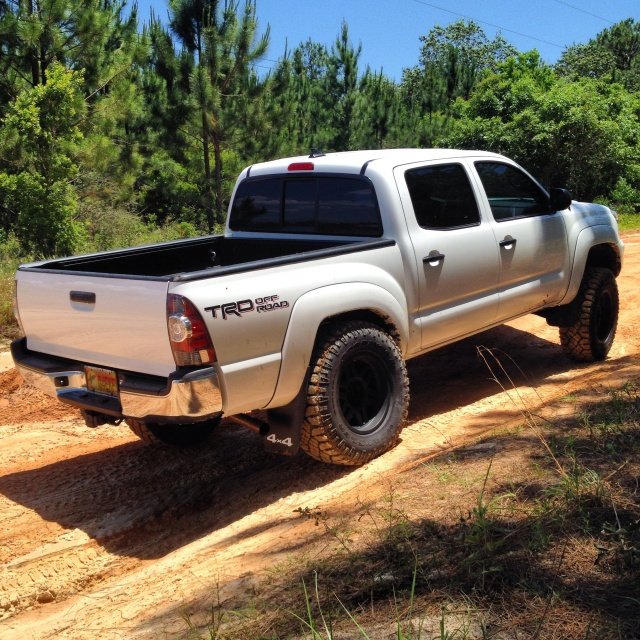

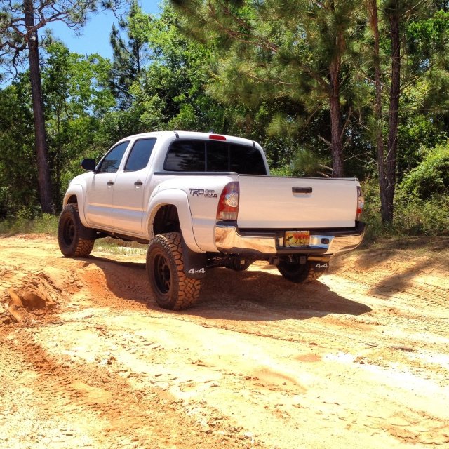

    I forgot to update you guys and show you my finished truck. Here's some pictures. The front sits 1/2" lower, I might buy a spacer and level it. Also contemplating removing the sway bar.

    Sorry if you posted it already but which springs did you go with? Also which tires are those?

    I went with 885 coils w/ a .5" spacer and 285/70-17 Goodyear Duratracs.

    Thanks! Looks good man! Ordered 885s a couple days ago I can't wait to install mine.

    Sweet! I would have went with 886, but I don't plan on a steel front bumper or sheilds. It rides good.

    Well, after drinking a case of beer in the garage just staring at my truck. I decided to order 1" spacers to replace the 1/2" spacers and level the 1/2" rake. I also pulled out my swaybar. I'll see how it rides on my offroad adventure tomorrow and make a decision.

    did you get extended brake lines for your setup? if not, how'd they look taking it off-road?

    Yea I went ahead and bought some allpro front and rear extended steel braided brake lines. To tell you the truth I didn't even check them when I was on the trail haha, but they are a lot longer and I noticed with the axle at full droop during the lift install the lines still had a ways to go before they were tight.

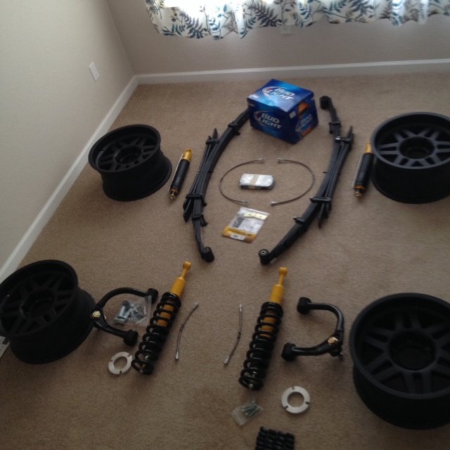

    Getting started on this install tomorrow, can someone double check my torque list?
    Rear:
    U-Bolts: 37 ftlb
    Shackle to frame: 89 ftlb
    Leaf at both ends: 89 ftlb
    Rear Shock Top: 15 ftlb
    Rear Shock Bottom: 74 ftlb
    Front - This is where the Service list gets confusing for me
    UCA to Frame (long bolt): 85 ftlb
    UCA Ball Joint to Spindle: 45 ftlb
    UCA Ball Joint to UCA: 150ftlb (May be LR UCA specific torque requirement)
    Coilover Assy to LCA: 61ftlb
    Coilover Assy to Frame: 47ftlb on each of the 3 studs

    It's been confirmed many times that the U-bolt torque is WAY too low. Should be more around 85 ft lbs.
