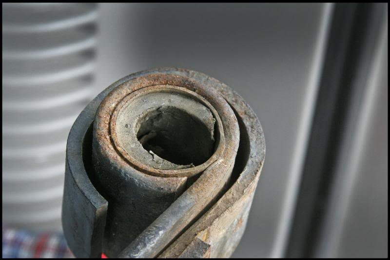

    I meant to post this a while ago but forgot. Some have asked about the bushings in the main eyes on the Dakars and replacing them pressed in bushing with poly ones.
    Well here a few pics from when I replaced my eye bushings a few weeks ago. The rubber bushings that came in the Dakars was shot and not doing it's job any longer. I chose to replace them with Toyota factory sleeved bushings (these are the same ones that are used in the Dakars when new).
    So some people want to replace these sleeved bushings with poly ones because a) they don't think the rubber will hold up as long, b) the sleeves can seize up on the spring eye as well as the inner sleeve can seize to the hanger bolt.
    Here's the problem with poly bushings here. If you look at how the Dakars main eye fits in the spring hanger you'll see there is not a lot of room between the spring and the sides of the hanger. Most poly bushings OME or otherwise will have a shoulder that is too wide to fit in the tight space. If you do find a bushing that will fit, the flex of the spring will tear through the shoulder on the poly bushings extremely quickly and you'll be forced to replace them again.
    The Factory sleeved bushings really is the best option. The Rubber will flex better than poly, you won't have to worry about the shoulders tearing off. The rubber will outlast the shoulder on poly bushings so you'll be replacing them less often than poly bushings. The trick is to LOAD the outer sleeve and inner sleeve with anti-seize so when the time comes to replace them, you can press them out relatively easily.
    Good luck.
