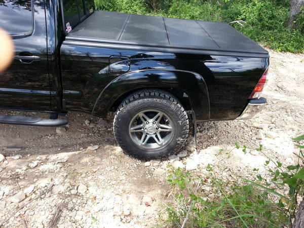

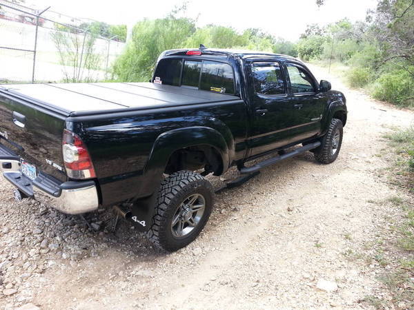

    I don't know, I think they're pretty good.

    Honestly they're good enough for probably anything I'll ever do. I think if I was a hardcore wheeler I would have noticed it before I had them over a year lol

    They could have made them a bit longer, but you go too long and the collapse length becomes an issue. With the collapse length too long you have to run longer bumps which takes from the uptravel.
    So yeah you will see guys with more droop, but this doesn't mean they have more suspension travel and thus no more gain in performance. Personally I'm not a fan of running into my bump stops hitting little shit; this doesn't make for a nice ride at all. That said they could have made these shocks about an inch longer to both maximize the droop of the packs yet still keeping the collapse length short enough to utilize the factory bumps.
    Basically lots of droop may look impressive, but its really not unless you have relocated the upper shocks mounts to support the longer collapse length shocks.

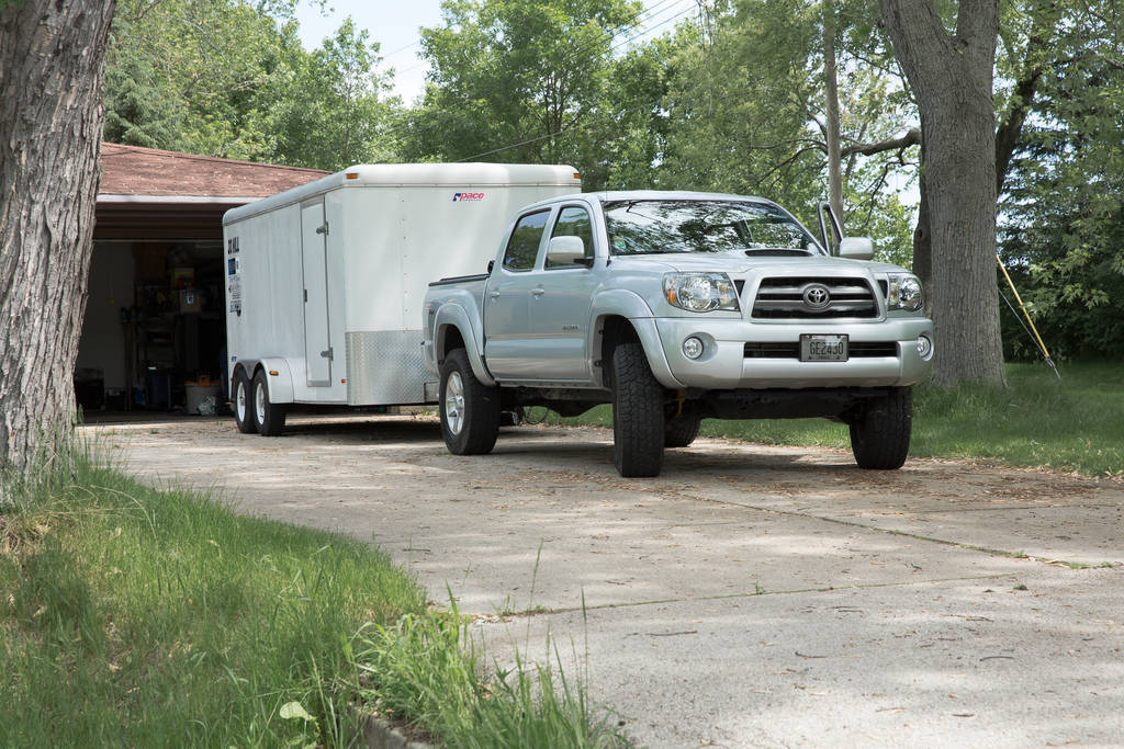

    So here is my truck with my trailer about 350 lbs tongue weight.....
    They work great.... about level with the 884s....
