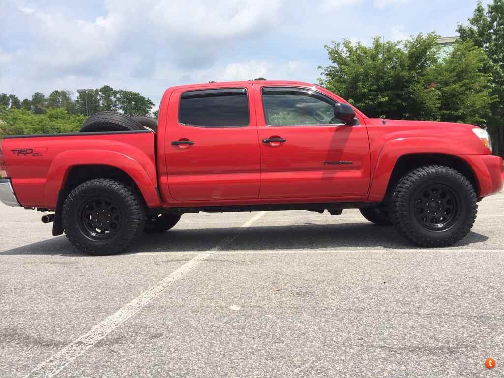

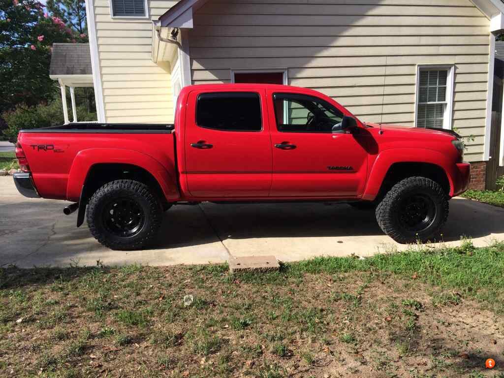

    885x, billies, 1.5 aal and 265/75/16 on my dcsb. I'm pretty happy with the result.
    Before
    After

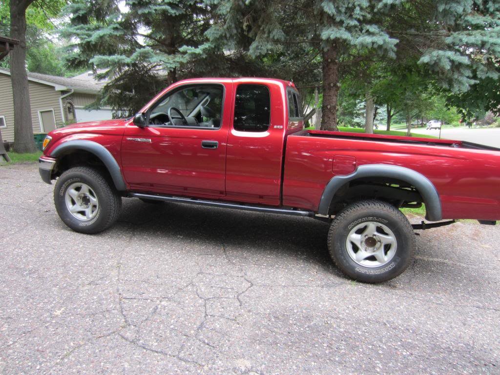

    It took maybe 30 minutes to do the front end, 3 hours for the rear end. All I had was hand tools and jack stands. I used ratchet straps to hold and help locate the axle during the dakar install. I won't get a chance to drive it until after work tomorrow but I'm very happy with how it went together.

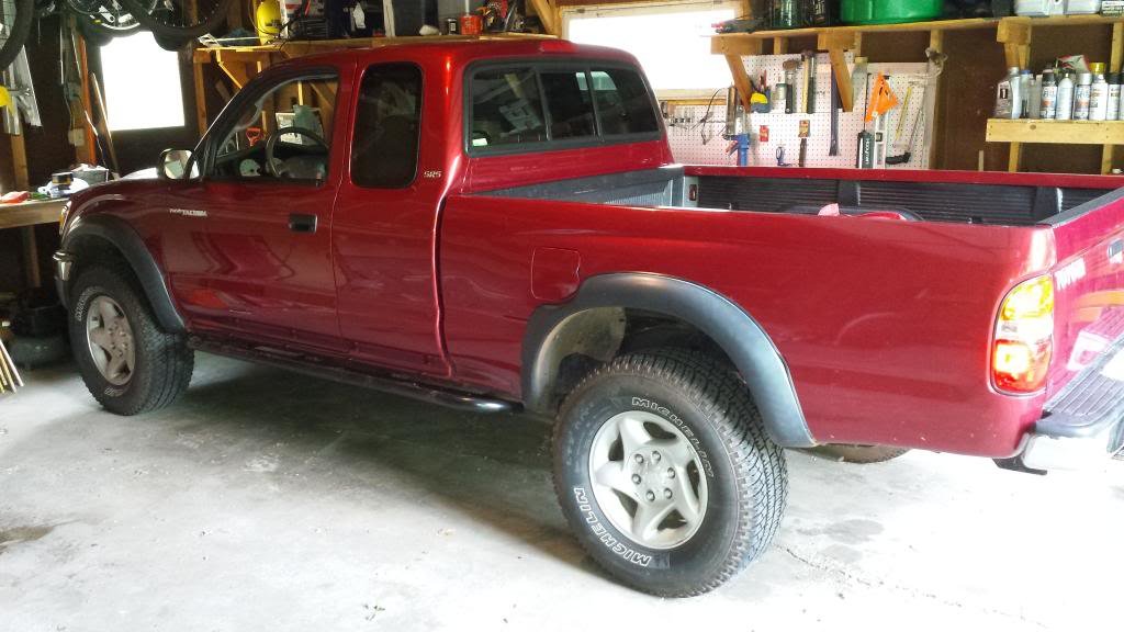

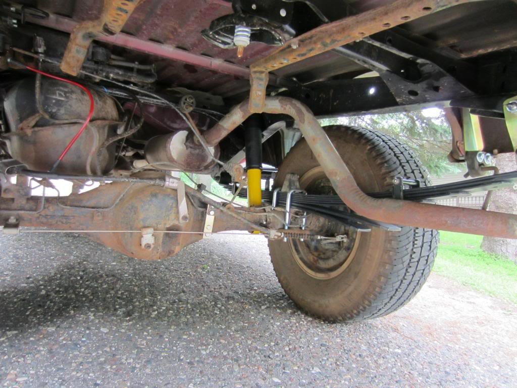

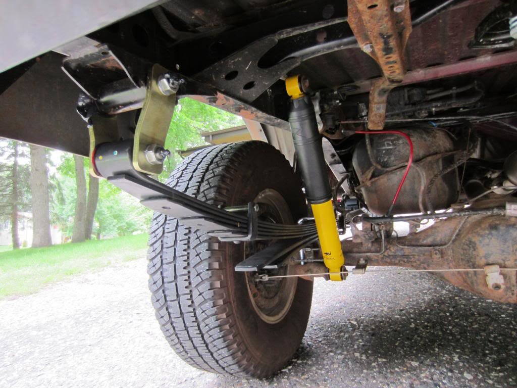

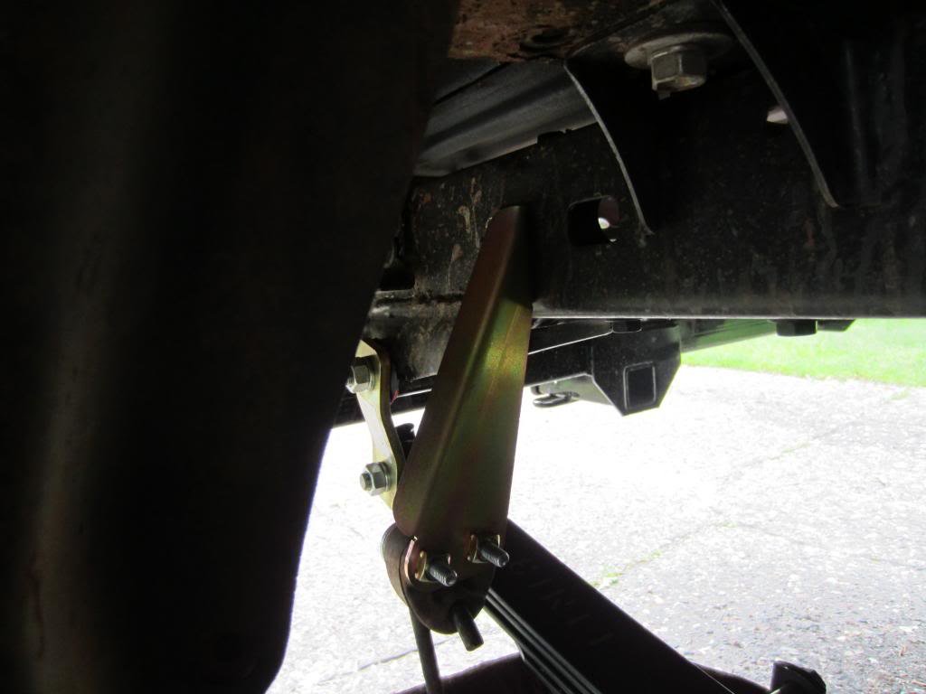

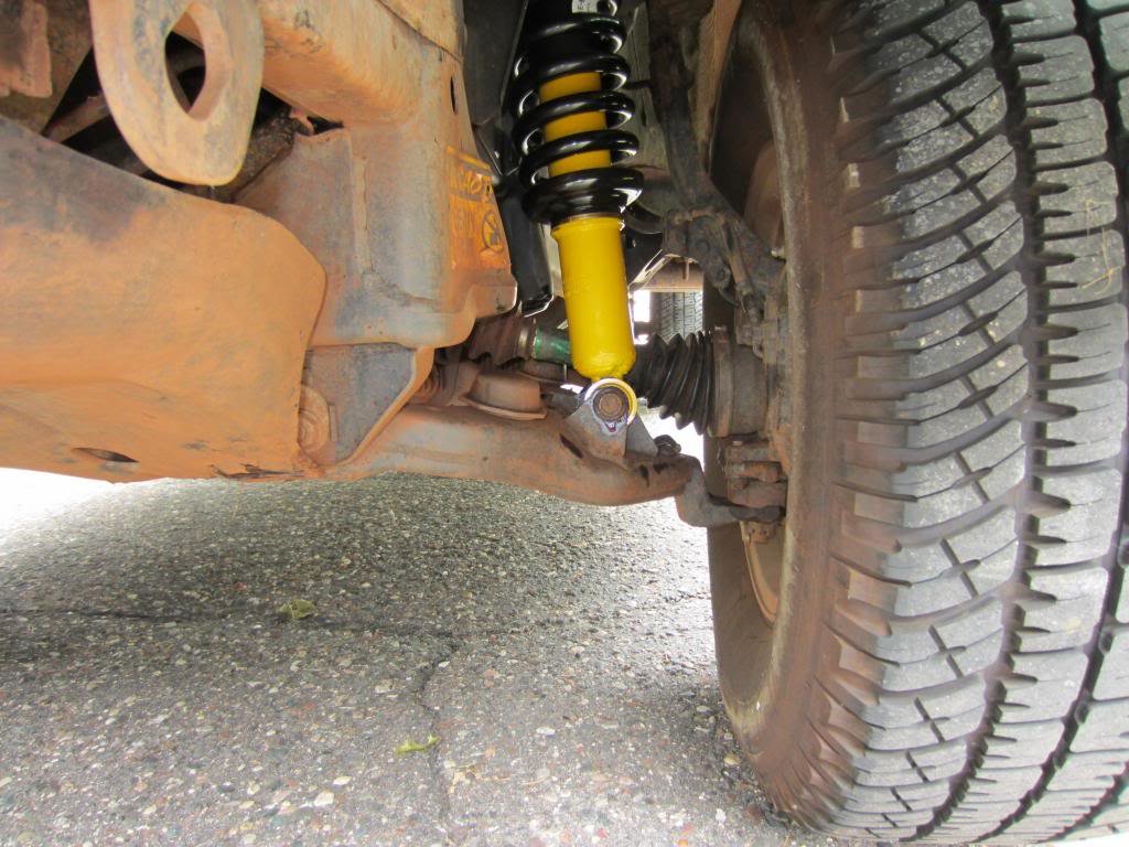

    Here are some more pics of the OME install yesterday. I get some trail pics this weekend. Once I drive it around a little, I'll also retorque everything. I'm also not running the swaybar.
    Front Shafts. Angle isn't too bad but I do have a diff drop kit that I'll get around to installing.
    Drivers side rear. The brake line and breather extension are plenty long. The greasable shackles are nearly vertical so there should be plenty of flex too.
    Passenger rear. The BPV bracket works reasonable well as the control arm is nearly parallel to the road. Also, though it looks like it in the pic, the exhaust does not hit the leaf. If it does, however, I'll just cut the exhaust back.
    Better pic of the exhaust bracket.
    Before.
    After. The rear axle did move forward slightly but not too bad. There is also a noticeable rake right not but I hope the leafs will settle in and level out.
    Overall, I'm very happy with the install. Final opinions saved for this weekend when I get to drive it 3 hours on the highway followed by 2 days in the rocks.
