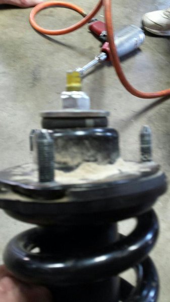

    2013 MGM DCSB TRD Sport 4x4
    SOS Front Bumper, SOS Sliders, SOS skids, ARB Rear Air Locker, OME Lift (885x Coils, Nitro Charger Shocks, Dakar Leafs), LR UCAs, Leer Shell, OKLED 30" light bar, Wet Okle Seat covers, etc, etc
    Does this rubber gasket go back on top like it was factory? uploadfromtaptalk1405112168732.jpguploadfromtaptalk1405112183897.jpg

    Lots of chrome
    Thats a bushing and yes it goes back on top.
    There should be one underneath the top hate as well.

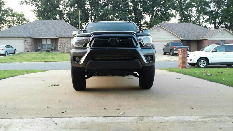

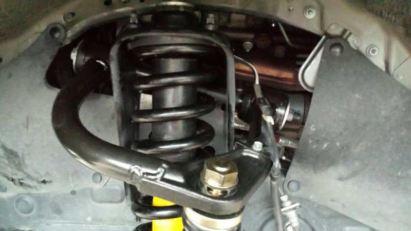

    Should I get over 3" with just 885 and trim packer? I'm assuming no. They are about the same height as my dakars I just put on. I have major caber issues as well. Something is not right. I got another 1" to 1.5" when I drove it 40 miles home. I was planning on an alignment in the morning, but something may be off. uploadfromtaptalk1405127338096.jpguploadfromtaptalk1405127379479.jpg

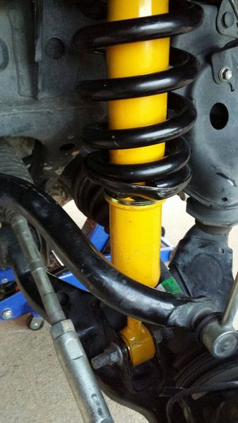

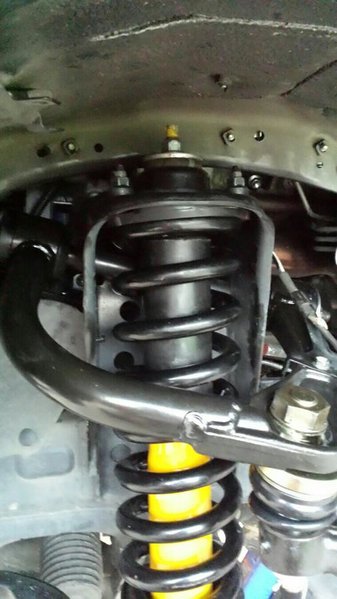

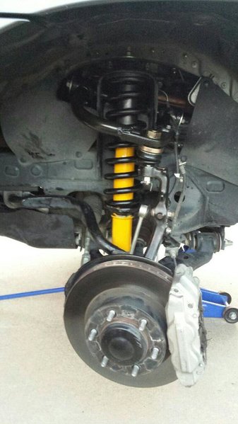

    Anything look off?
    uploadfromtaptalk1405128286675.jpguploadfromtaptalk1405128305243.jpguploadfromtaptalk1405128332435.jpg
  17. Jul 11, 2014 at 6:29 PM
    #4877

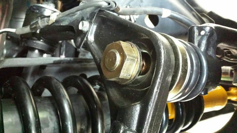

    Maxx
    Maxx Well-Known Member
    Dec 30, 2012
    #94017
    1,397
    I noticed your UCA ball joints are set all the way inward, I set mine all the way outward and had it aligned there. Can you snap more pictures of the suspension? You should be able to adjust the LCA cam bolts and get it a little more reasonable until it's aligned.
    You said you got another 1"-1.5". Of what?

    cstallings
    cstallings Well-Known Member
    Mar 25, 2013
    #100538
    1,208
    Arkansas
    I got another 1.5" lift when I drove it home. I know the LCA can be adjusted, but I wanted that to be done at the tire shop. I pushed the ball joint in to help with the tire lean. It will lean more if I pull it back out.

    What picks of the suspension do you need?
