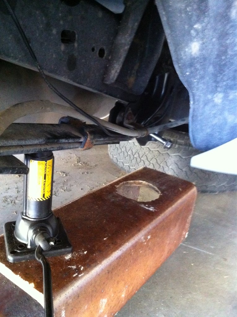

    U-bolts already on?

    Ubolts are off. I'm taking this leaf off not putting on

    Pull that little bolt on the e-brake cable hangar out. It stops it from coming out.

    Managed to get it out, now to try and get the leaf removed. Ugh. I'll let u know.

    When I installed the Dakars by myself, I put the front in and loosely bolted it. Then I summoned the power of Grayskull and He-Manned the rear shackle into place while shoving the bolt through the hole. After that I jimmied the centering pin into place and on put the U-bolts in.

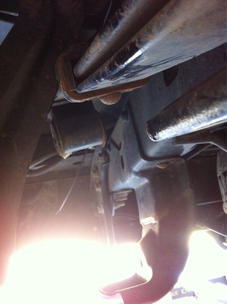

    I'm putting new dakars in but right now I have a bigger problem getting the old ones out. All the bolts are removed but the rear shot up when I put the jack on it. Now it's stuck.

    I believe I shoved the front toward the rear and twisted it out when that happened to me. There's a bolt head up there it binds up on pretty tight. You can also put your stock jack between the spring and the frame somewhere to push it back down so you can swing the whole set over sideways.

    Thx I'll try
