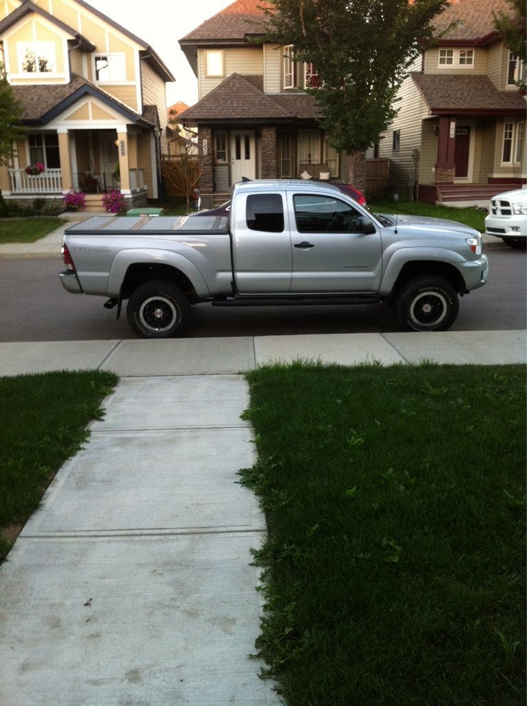

    Finished! Waiting on terra grapplers and alignment.
    Surprised how smooth the ride is. OME is nice.

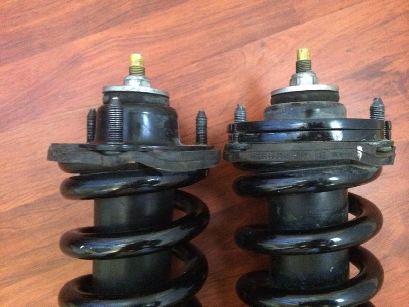

    Anything wrong with these?

    Glad to see you got it done!

    Thx man. Rides pretty nice. I get alignment tomorrow morning. Feels like I have a little shudder on taking off. I'll have to look into it.

    Cant tell from pic .got more views better lighting? Send pic of top hats

    Can't see

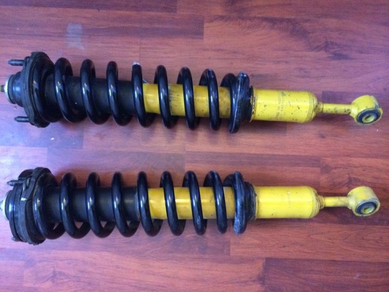

    Here you go

    I assume bottom is driverside?

    Are they installed corectly?

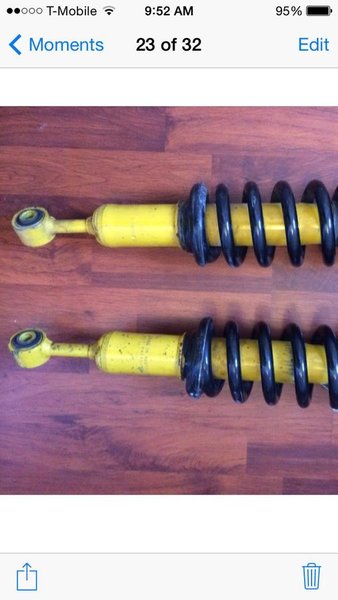

    Here is the bottom

    Do you have two top plate spacers on one ?

    That one coil seat looks bent or buckled , no trim packer and the top hats are different , are these used ?
