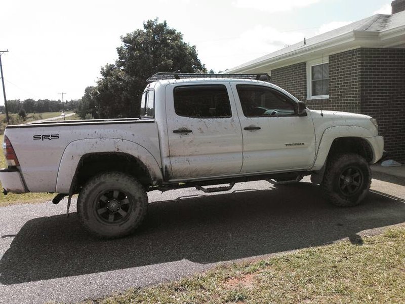

    Honestly if you are thinking of 265/70 I would k st get the full set up..I have five inches from hub to fender and I'm on 265/75/16 and i look perfectly fine uploadfromtaptalk1408486846127.jpg
