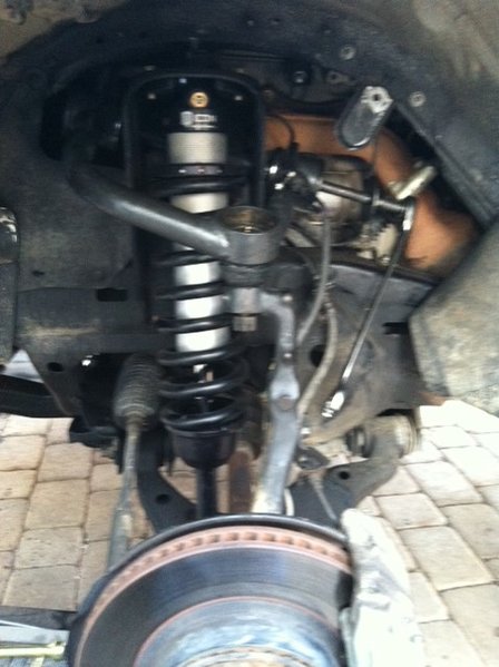

    +1 for bending the sheetmetal and sliding the bolt out just enough to remove the UCA.

    Like this..

    My intention of posting the picture was to show where you would bend the metal back to make it easier to get the UCA bolt off. Now that I have a second look at the picture, it doesn't really show that. My mistake.
