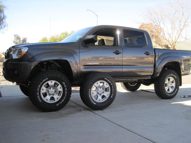

    These are BFG AT 285/70/17. On XD wheels with 4.5" backspace

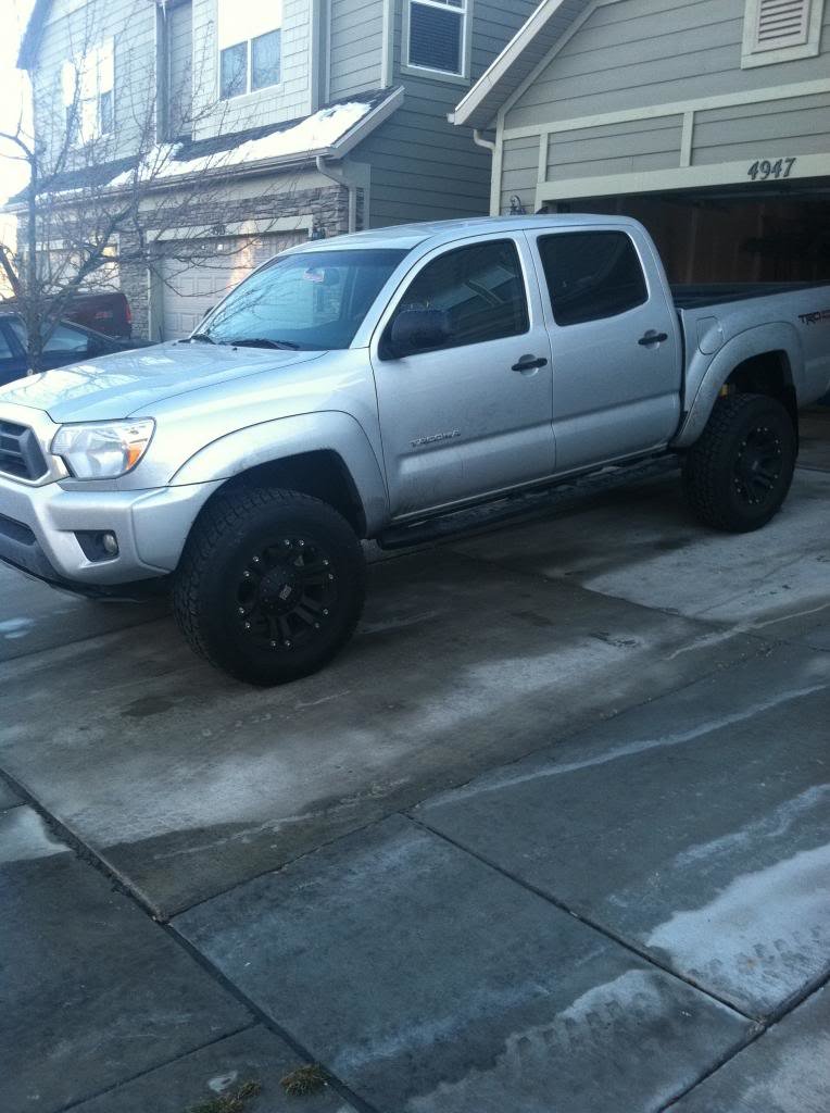

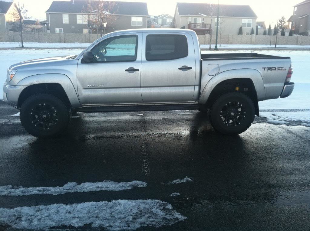

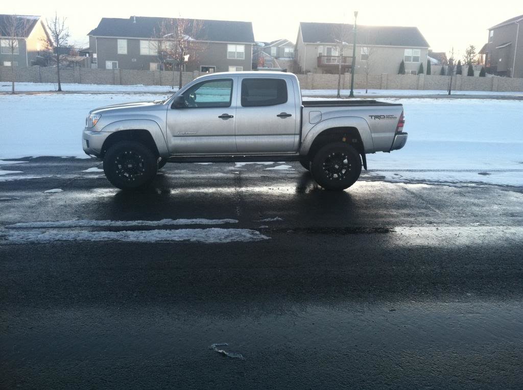

    Thanks Beavis, I need to give it a wash but we have had tons of snow here in Utah! It is 100 times better than the stock suspension/spacer lift I had on! Once it settles/breaks in I assume it will get even better

    looks awesome! tire size please

    Looks like 285/65/18

    Yep. 285/65/18

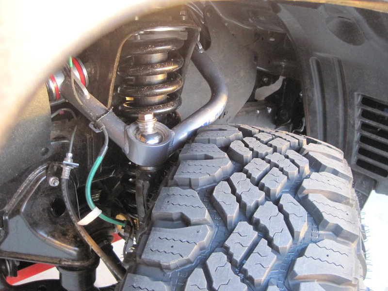

    I got my new tires today. 285/75/16 on OEM rim will NOT work. Even with TC UCA it still rubs on the UCA. You need Spacers or diffrent rim.
