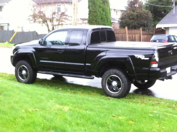

    11 sport
    2 inch add a leaf, OME 885x on 5100 shocks
    stock upper control arms and alignment is within spec, caster 1.6 so a bit low.

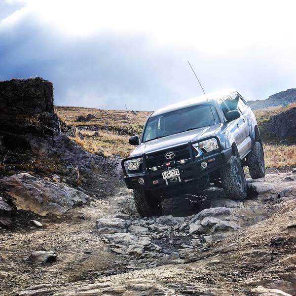

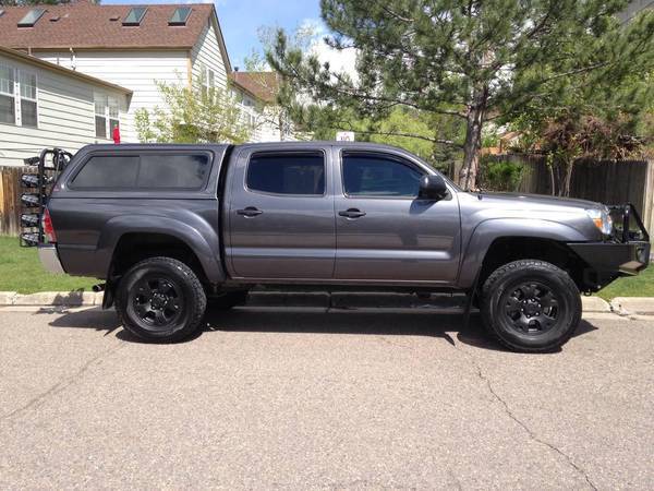

    Installed: K&N COLD AIR INTAKE, WeatherTech Floor mats, Weather Tech Side window deflectors, Leer Cap 100XR, ARB FRONT BUMPER, OLD MAN EMU HEAVY KIT, WARN VR10,000 with wireless remote, rigid led's, Cooper discoverer ATP 265/75r16, ARB Differential Breather, IBS Duel Battery system, Engel 45l Fridge with slide. 4x Innovation Sliders, 4X innovation's rear Bumper with Rigid Defused flush mount,
    I love all the pictures/question's and set up's!
    If you have OME post a pic
    Tell us what you got.
    I purchased the Heavy kit
    2886 x 1
    90000 x 2
    CS047R x 2
    60091 x 2
    OMEU53A x 4
    FK29 x 1
    I'm not sure which one of those part number's is the add leaf in the rear but I did install it. I have a ARB bull bar bumper and a warn VR10,000 steel cable up front, and always have work supplies/gear in the back. The ride is amazing.
    What did you put up front & what did you get?
    What did you put in back & what did you get?
    I didn't take any measurement's! sorry guys.. I was to excited to get everything on to stop and look for a tape.
    Are you running trail armor & how much lift did you loose or what did you do to regain/maintain lift?
    I'm planning on running 4x innovation slider's, and a duel battery up front, Not expecting to loose that much lift (if I do I'm just going to drive it)
    Tire & wheel specs & rub or what you did to eliminate rub.
    265-75r16 no rub at all but I do take my mud flaps off when on harder trails. no spacers
    Are you still running a sway bar?
    Yes, part of my job is driving a lot in the mountains, colorado has a lot of turns.
    Getting it Dirty[​IMG]

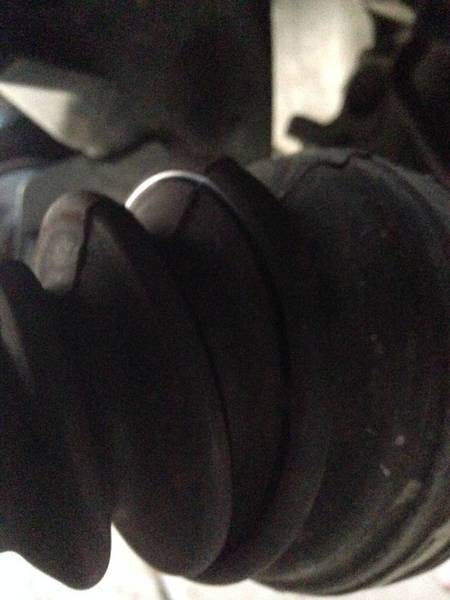

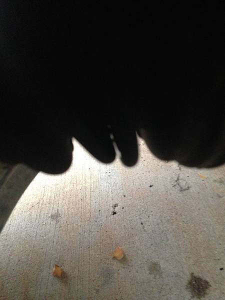

    I do have a question about my CV's, Has anyone installed a diff drop? I know how people feel about them and I Don't want to install one or derail the thread into a diff drop thread (there are plenty of them). My cv boots (the inside ones) have rub marks not the outside ones they are not touching at all I'm not sure when they rub (HWY I'm guessing) if I look at them wile it is sitting in the driveway they are not touching. Who else has rub like this? How long has it been leaving marks? I have a friend with the exact same lift and truck and he has rub marks with over 50k on the lift never changing the CV's. I have 15,000 on my lift.
    Hard to see, But it's not touching wile sitting..

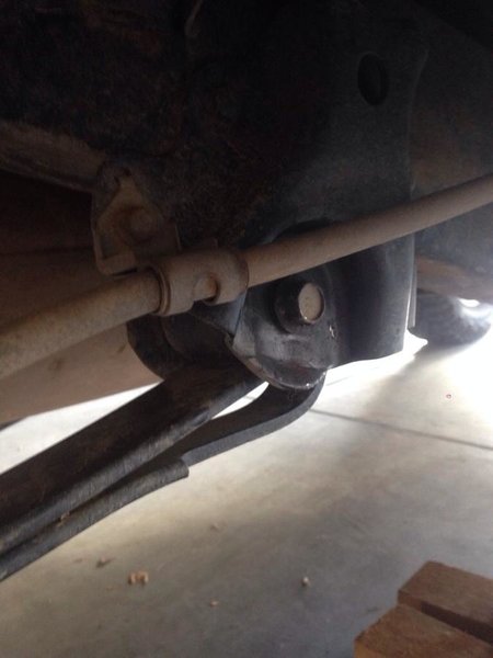

    Anyone else have issues pulling the front leaf spring bolt? Mine will twist, but will not pull out. Any thoughts on how to get it out?ImageUploadedByTapatalk1414275188.038394.jpg
    I can't get behind it to hit with a hammer because the muffler is in the way. I tried a c clamp, that won't budge it

    never mind, I'm an idiot
  16. Oct 25, 2014 at 3:29 PM
    #5416
    GeoTaco
    GeoTaco the town is back that way
    May 26, 2009
    #17652
    2,676
    Freeda Feltcher
    Denverish
    '21 Army Green TRD OR DCSB
    Car seats
    Turns out it's threaded all the way....... Was not expecting that

    Wanted to update previous post.
    I am now at 2.5-2.75 inch front lift after the 885x on my access cab.
