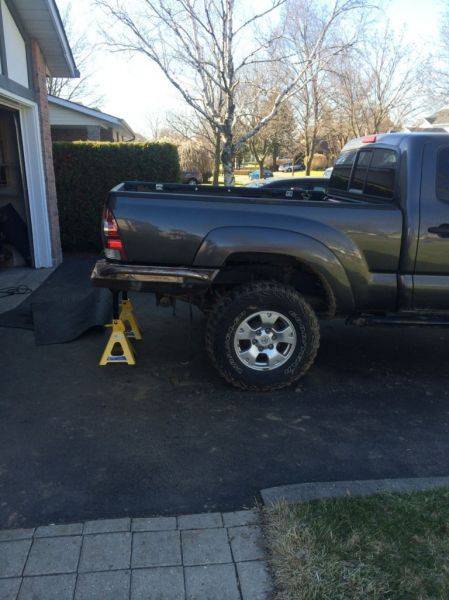

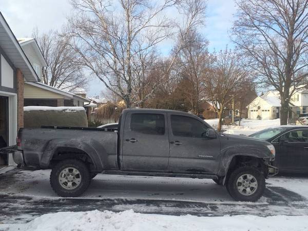

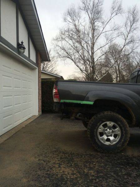

    cant comment on the front setup but for the rear, I have a high clearance bumper and didn't notice any sag.
    right after lift stock rear bumper.
    about a year later with bumper removed bedsides cut
    and with bumper on.
    Think I had one bolt per side to hold the bumper on.
    This pic shows the rear end better with the actual bumper on and maybe a couple thousand KM on the suspension. I don't remember if the trailer was hooked up though, but I don't think it was EDIT:the trailer jack is supporting the trailer I believe, and im unhooked
    Don't think there was much sag, but my very first pic was right after the leafs were installed, so they hadn't really settled. The other 3 pics were from this summer, which was almost 8 months difference.
    You can also see my front end in the first pick, compared to the last pick. I have 886's, and I think they settled a little bit. Don't know if it was from the bumper, just the leafs settling in general, as I put the bumper on right after the suspension was installed.

    Thanks for the detailed response and pics!
    Rear should be good to go...
