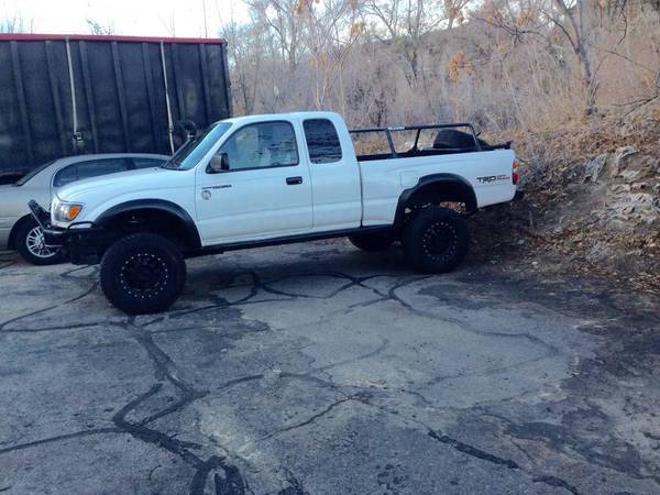

    Pretty much stock with some crap welded to it.
    heres a crappy cell phone pic
