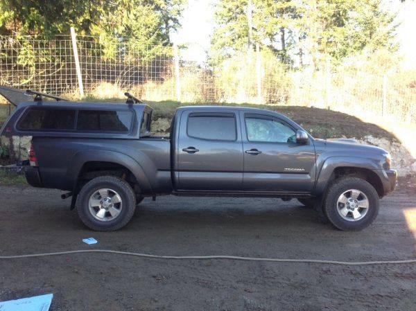

    any one with pictures with 17's and 275/70/17 tires?

    Thanks OZ
