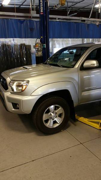

    I have been creeping on these forums for a while now and always found answers to my questions without needing to make an account. I finally bought a Full OME Kit on Black Friday weekend from Toytec. They have fantastic customer service and the price was right. I went with the 90021's in front, 887 coils for a full 3" lift (w/ trim packer), 60091 in rear with the CS407R leaf pack, and the FK29 driveshaft spacer. I had them build assemble the front strut/shock assembly because I didn't want to deal with that.
    I also went ahead and got Method Mesh (17x8.5) rims as well, still on stock rubber (Bridgestone Dueler 265/65) because I cant justify tires at the moment.
    Before:
    Measurements:
    DF: 20 1/4
    PF: 20 1/4
    DR: 21 1/2
    PR: 21 1/2
    After:
    Measurements:
    DF: 23 1/4
    PF: 23 3/8
    DR: 24 3/4
    PR: 24 3/4
    All together took my 6 hours with one other person helping. That was from pulling onto the lift, putting the lift on, an alignment, a wash (cause the wash rack was open... why not?), driving to my house and getting the rims, taking them to Discount Tire to mount and balance. I was very fortunate to have people with knowledge about suspension, a lift rack, and a friend at Discount to help me out.

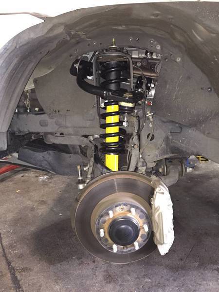

    Hey guys...if I just installed my 885's/90021's and the rubber under the top plate is oozing out from the spring pressure should I get an aftermarket one? Does it even make that much of a difference on my height at all?

    You should be able to see it here. On top of the I added 1/4" plates on the top and thought from what I read here I should be close to 3". I'm only at 22.25"-22.5" hub to fender.

    definitely see what you are talking about.. its hard to tell.. but I think may have the bottom of the strut assembly upside down.. can't for sure tell.. do you have trim packer?

    Is the coil seat upside down ? Hard to see on my phone

    that's what I was thinking OZ.. but would that cause his issue up top?.. too much pressure pushing up on it?

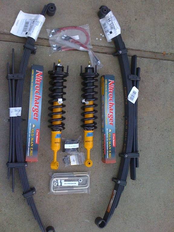

    I'm not completely sure the strut is assembled correctly. Compare:
    Look at how the spring rests on the bottom of the spring perch.
    With no load on the strut, it shouldn't be under extreme compression to deform the rubber.

    Yeah your bottom spring perch is definately upside down. Should raise the bottom of the coil above the retaining ring on the shock, not drop the spring below the ring.

    Yeah I noticed that and had the guys fix it. But the rubber is still getting pinched. The pic you have of them assembled isn't the factory rubber and top hat. That looks like it came pre assembled.
