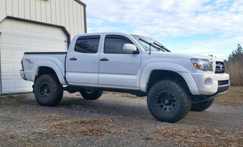

    Just put on 5100s front and back and 887 ome springs, 2in aal, 285 75 16 tires.166b310_cb942ed501d1f98d6dc2ca85486ca33febcfc03b.jpg

    Looks great

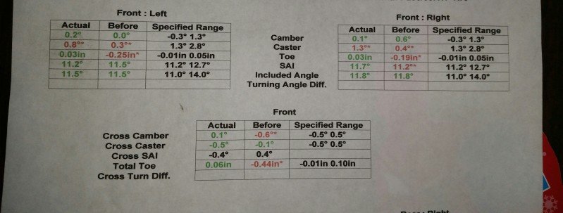

    Very happy with the set up what a difference over the spacer lift I had alignment went great to my caster is a little off camber and toe are in the green next are some ucas after Christmas tho.

    Here's my alignment number stock ucas2h830it_dfc24b59cbd7b7592dd66cecc66a2984172a3153.jpg
