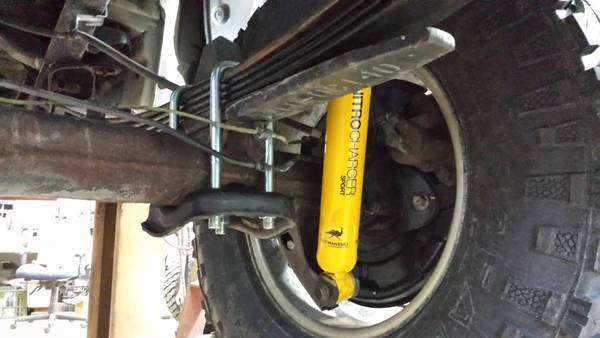

    ok got a question for the experts in the room. I just installed 885's/90021's upfront with 7mm trim packer on driver side and 1/2" top plates spacers on both sides. And, I'm only sitting at about 22 1/4" on both sides...? I expected to be at 23.5" for a full 3" lift with the 1/2" top plates. I have a 3/8" spacer I'm thinking about stacking to get to 3". What do you guys think? How much more spacer do I need to get to 3"?

    Is the spring upside down? Sure everything was installed right post a pic if you can.

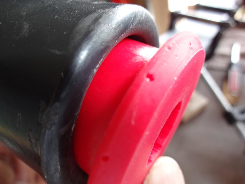

    Merry Christmas fellas! I took some pics of the bushing kit Toytec sent me and the fit into the rear spring eyes. I sent the same pics to toytec for their opinion but looks a little loose to me.
    Theos, do you remember if yours were about this fit?

    Spring perch upside down ?

    You realize the 5100 perch and the OME perch go in different directions ?

    Yes sir. In fact I had a buddy install it while I was at work and they installed one of them upside down the first time around. This is when the perch was installed upside down...right?[​IMG]

    Post pics

    No, the bushings Wheelers sent me were black and seemed to fit just right. Not too loose and not needing tools to get them in. I used Superlube on all areas that could possibly have friction

    Upside down spring perch as far as I can téll on my phone

    Yeah that's what I noticed as soon as I picked it up. But I had it flipped and I'm still at my height. I have no other choice but to add another spacer. But if I'm only getting 22.25" with 1/2" spacer do you think I'll be able to add a 3/8" spacer to it and end up right under 3" total lift?
