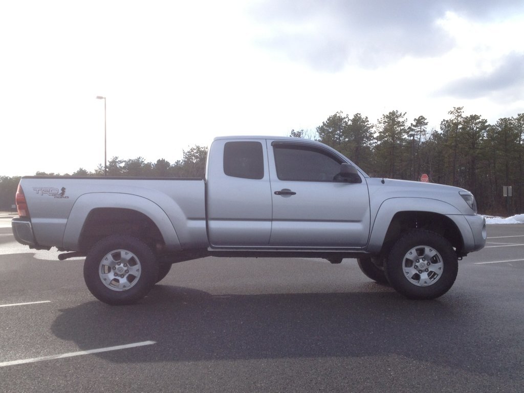

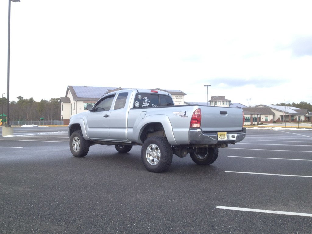

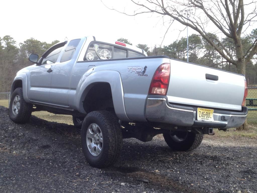

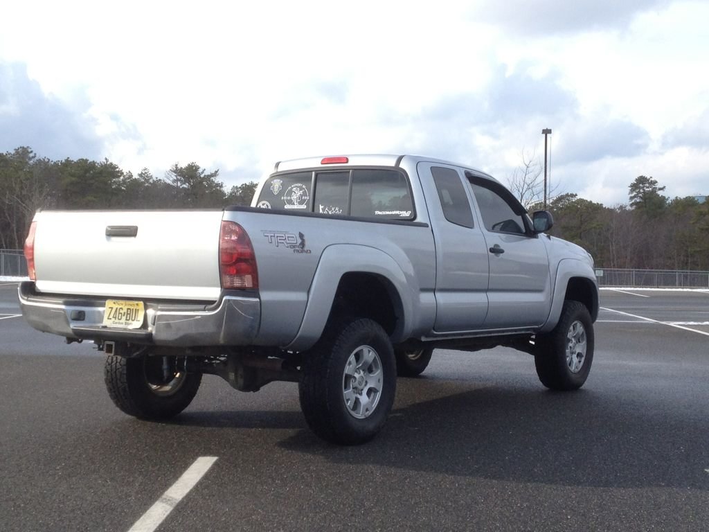

    Looks good Jeff.
    I remember the post lift pre tire days. What size are you going with?
    Before
    After

  3. Feb 3, 2013 at 11:47 AM
    #563
    nj636
    nj636 Hub Master General
    Feb 14, 2012
    #72804
    5,389
    Kev
    Jersey
    OME lift 4x sliders 4x skids
    extended travel 5100's in rear

    :yay:You finaly got it back together!
  5. Feb 3, 2013 at 11:50 AM
    #565
    nj636
    Feb 14, 2012
    #72804
    5,389
    Kev
    Jersey
    yes :woot:
    can't believe how nice it rides. very happy with the components so far.

    looks good!

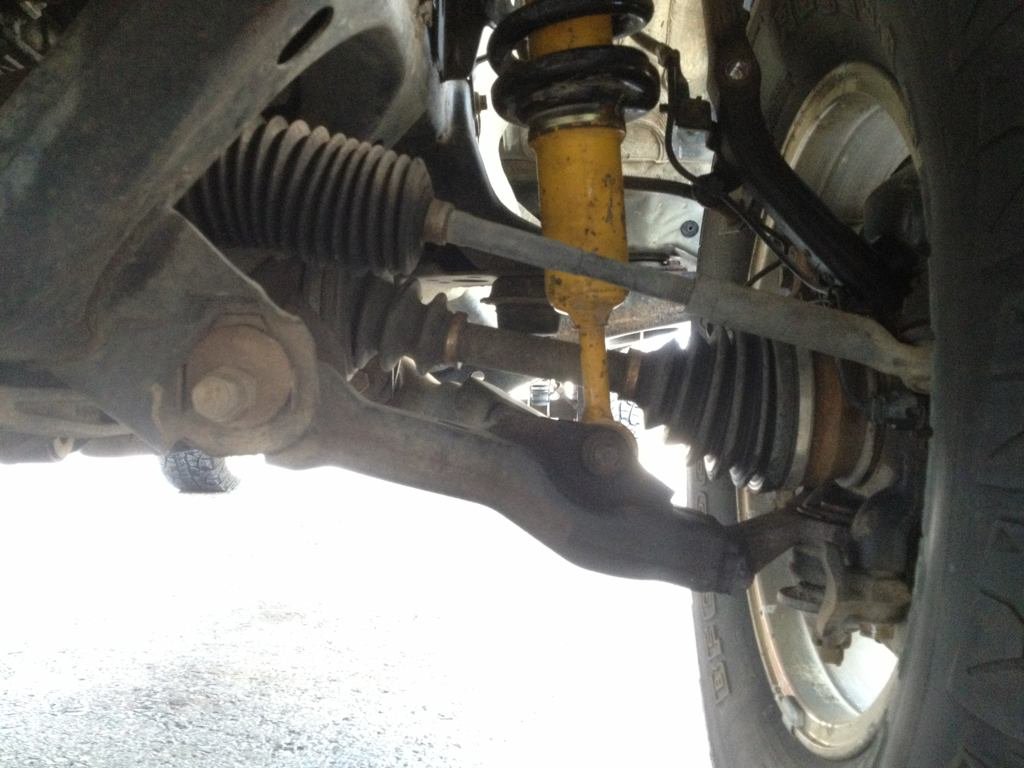

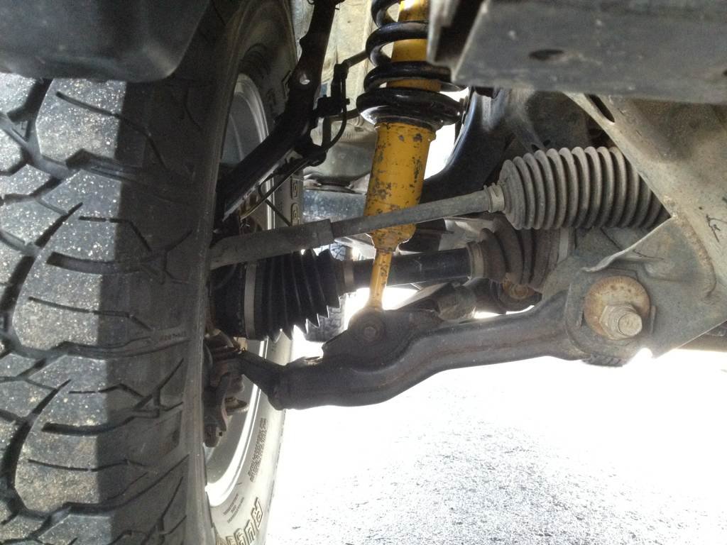

    Are you going to try it without the sway bar?

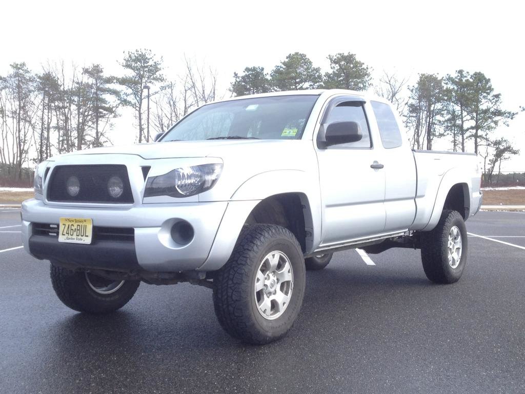

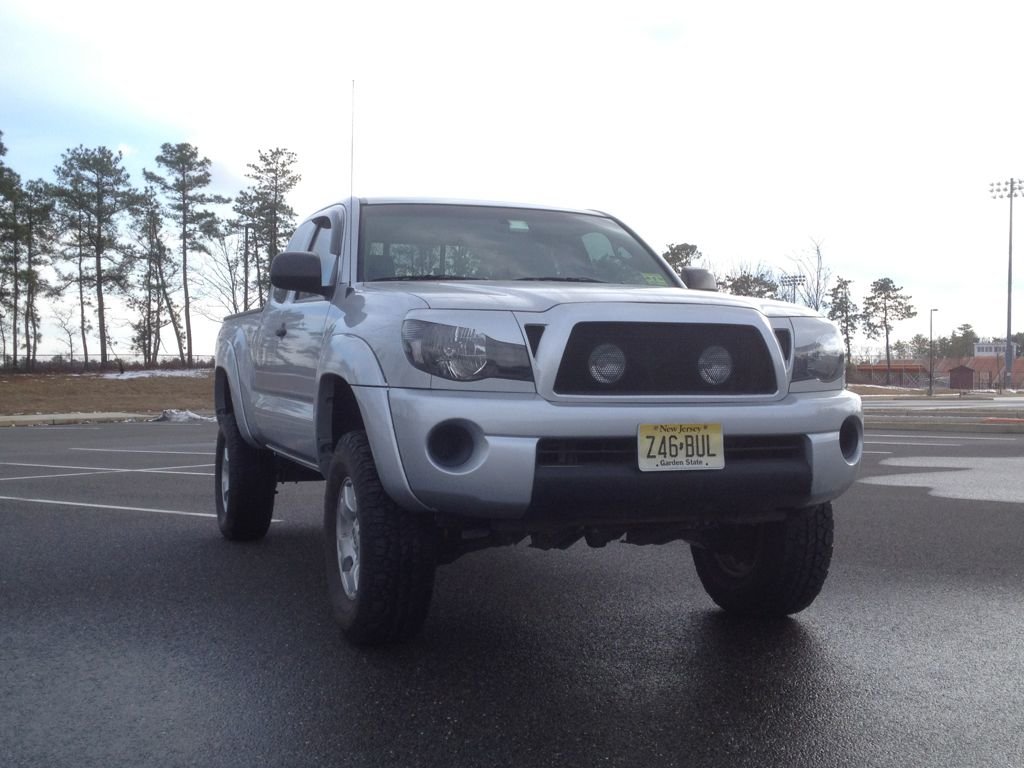

    Randy~ I think for now I may order some wheelers type b with either a 33" x 10.5 or 12.5. I'm still undecided. Your trucks looks nice btw!
    Kevin~ Nice to see your rig back together! It looks real proper now. Plenty of travel and ground clearence. I'm glad I got finished yesterday. Today started off real miserable here. What's next for you? Getting those rims mounted on I hope

    next will be an order with tread wright for 285/70/17 guard dog m/t's

    sway bar is out
    cv angles no diff drop
