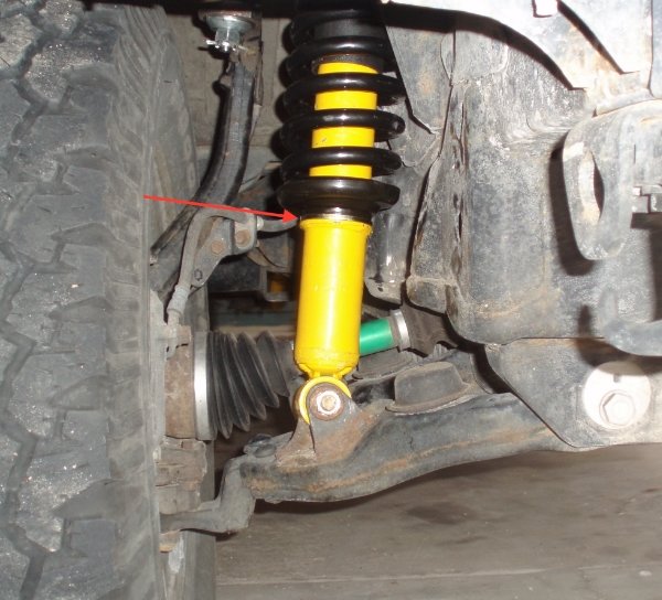

  7. Jan 23, 2015 at 1:01 PM

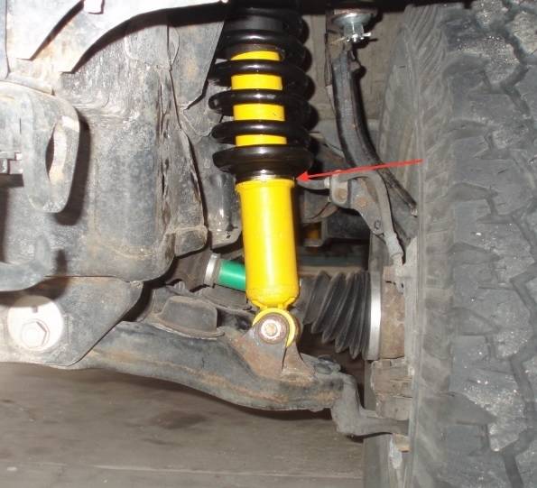

    You should be able to see it right under the bottom of the spring seat, gold/brass colored ring.
    edit: pic added

    Thanks for the pic. Just checked - it's there.
    My OCD is bummed about still being 1/4" low though. I'll live.

    Is it just me, or is that a pic of the trim packer on the passenger side?

    It's the drivers side that's low - even with the packer.
