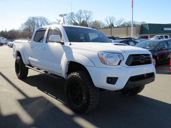

    I think it may be a tuff choice between the 886 and the 885 if you want 3 inches of lift, with a hidden winch. I ran no weight on the front end with 886 springs and the ride wasn't bad at all.
    This is with the dakars and 886 no weight on the front.
    Have the bumper on now and the ride hasn't changed much.
    For the rear I have the dakars and they are sweet. You should be able to run them with a lot less air.
    Unloaded with bumper
    Loaded
    I up tire size between the pictures with different rims, so just keep that in mind.
