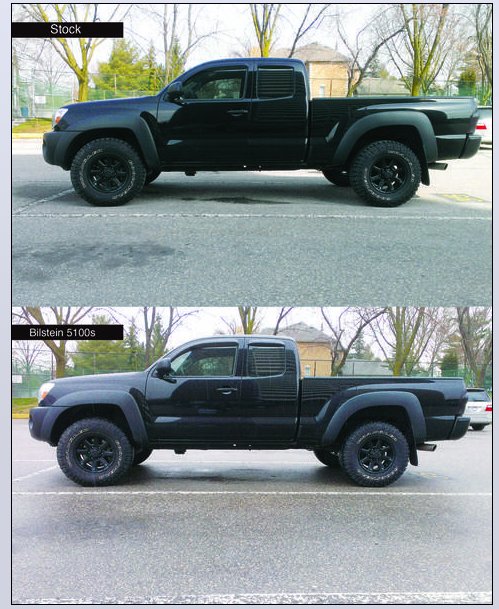

    #27584
    50,587
    Peter North

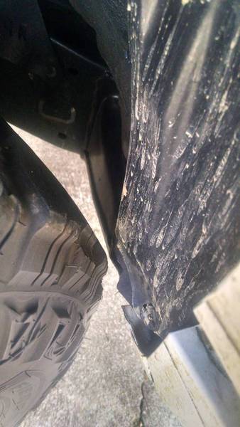

  5. Jan 31, 2015 at 9:29 AM
    #5845

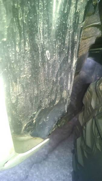

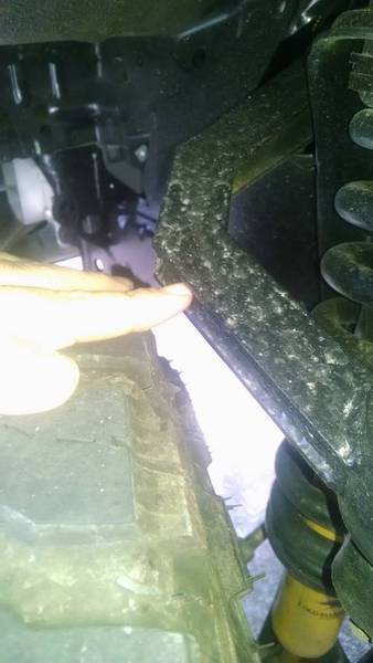

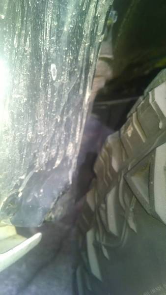

    So far the only place it is rubbing is the inner fender liner. It is around 1-2" from the cab mount. This is on a level surface nose slightly down hill. I got a few pictures.

    ^^^ Looks like you're just in need of some fender trimming. 1-2 inches of clearance everywhere else is within acceptable range of not having to make any other adjustments. Before I trimmed my fender a little it made a lot of noise in a turn. More bark than bite though.
