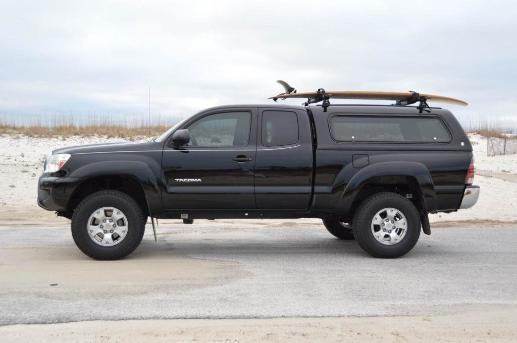

    This thread helped me a ton deciding on my lift. Figured I'd throw mine up. Maybe it'll be useful to someone. Bilstein 5100's front and rear, OME 884x's, wheelers progressive AAL (left overload in), 1/4" driver side spacer, LT 265/75/16C toyo open country AT2s. Got right at 2" all around. No vibes. Alignment is good. Rides great.

    How is it on bumpy roads? I'm sold on the 884s but can't decide on which shocks. OME or 5100s

    What's your hub to fender #'s ?

    Roads are mostly tar and chip here. Rides amazing. So muck better than stock. Can't speak for the OME shocks but I'm loving the billies

    Buddy threw my measurements away. I'll remeasure tm and let you know

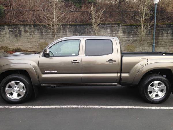

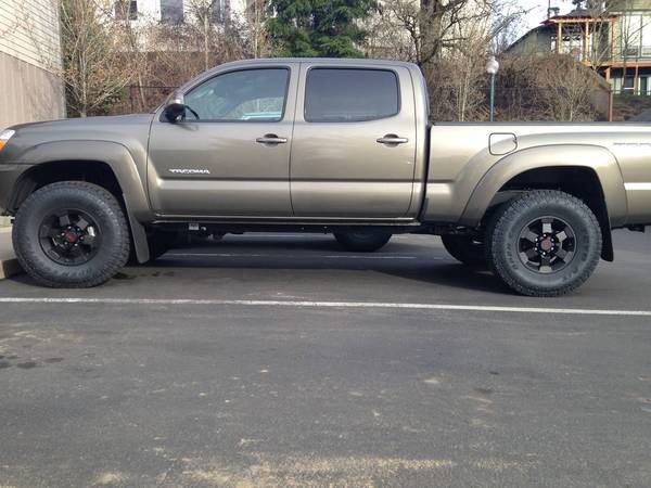

    Just had my OME lift installed, here's some before and after pic for anyone curious/interested. (Not the best angle on the before pic, almost looks like the same height as the after).
    I installed the OME kit from wheels with 885 & 90021 on the front (no top plate space) and the wheelers progressive AAL & 60091 on the back (no over load spring).

    Your truck looks good! Are your new wheels on 265/75's?

    Tires are 285/75/16 Toyo AT II
