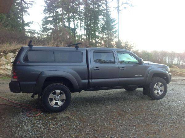

    OZ-T
    OZ-T I hate my neighbour
    Dec 15, 2009
    #27584
    50,587
    Peter North
    British Columbia
    885x , no top plate spacers , 90000's up front
    Dakars , N182's out back
    LR UCA's
    LT275/70/17 Hankook ATm's
    nwmo and dan81finn like this.

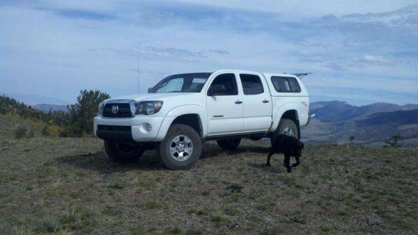

  3. Jan 17, 2013 at 8:16 PM
    #43
    kieth
    kieth Well-Known Member
    Oct 30, 2010
    #45462
    181
    British Columbia, Canada
    06 trd
    Full OME lift with Dakars, 886s and LR UCA's, Firestone air bags w\ onboard compressor, 2 kicker CVT 10" subs , MB Quart 1000w amp ,Alpine media player
    886's w N90000's in the front. Dakars with N182's in the rear. Not really sure what I got cause I've never taken any measurements. Curious to see how the 886's do when I put my Allpro front bumper on that is sitting in Calgary, wish it was in my garage.

  5. Jan 17, 2013 at 8:21 PM
    #45
    OZ-T
    Dec 15, 2009
    #27584
    50,587
    Peter North
    British Columbia
    Thanks
    It's a LEER 100RCC commercial cap with a reinforced roof and rack system rated to carry 400lbs

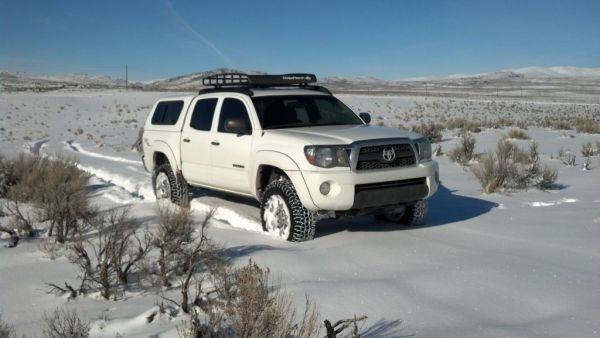

  6. Jan 17, 2013 at 8:23 PM
    #46
    skidooman
    skidooman I'm your huckleberry
    Apr 6, 2011
    #54438
    5,685
    TJ
    Northern Nevada
    19 Taco
    Kings, JBA, BAMF, C4, Deaver, Prinsu, TJM, SnugTop, 5.29s
    Upon initial install.
    What did you put up front & what did you get?
    885x on 90000 Sport Nitros gave me 2.5".
    What did you put in back & what did you get?
    1.5 AAL gave me 2" with shell.
    Are you running trail armor & how much lift did you loose or what did you do to regain/maintain lift?
    Not yet, I have a Relentless front bumper on order. Sliders and skids arent far off though.
    Tire & wheel specs & rub or what you did to eliminate rub.
    265/75R16 Toyo AT II on stock wheels. No rub & no trim.
    Are you still running a sway bar?
    Not yet. Next days off, if its above freezing.
    As it sits today(6-21-13)
    885x on 90000 Sport Nitros gave me 1.5" after armor and winch.
    Relentless front bumper, and TJM winch. Lost 1"
    Yes, with no relocate or issues.

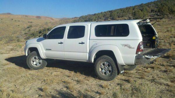

  12. Jan 19, 2013 at 3:56 PM
    #52
    kieth
    Oct 30, 2010
    #45462
    181
    06 trd
    AZ Mike- yes I got LR UCAs, I didn't get them right away and it was awful. Truck felt really weird on the highway, Caster was out of spec. Also I would jack the front of the truck up by the frame and the stock UCAs were resting against the coil springs-not good. Some say they can get alignment specs in with 885s, great , but your down travel is next to nothing with the stock UCAs. Also I'm not running any top plate spacers and I have 17x9 rims and 265's. I would definetly go with the 285s next time around.

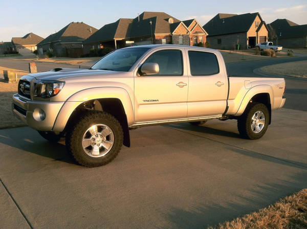

  18. Jan 19, 2013 at 4:47 PM
    #58
    JonnyBb
    JonnyBb I have to return some videotapes
    Mar 26, 2011
    #53778
    2,773
    Arkansas
    2021 TRD Pro (upgrade from my 2nd gen)
    Work in progress, but mods so far; OTT 7.0 tune, 255/85/16 Falken WildPeak M/Ts
    LR UCAs, N140S shocks, 885Xs, trim packer, and TP14 spacers = 2.75" lift
    N182 shocks, Wheelers 3-leaf 1.5" AAL with overload installed = 1.25-1.5" lift
    No armor
    265/70/17 Duratracs on Sport rims with Spidertrax wheel spacers. Very minor rubbing on the mudflaps at full lock in reverse...not enough to concern me
    Sway bar is still installed. If I was going to offroad more I would consider pulling it.
    FWIW, I had stock UCAs prior to installing the spacers (e.g. <2.5" of lift) and my truck handled like crap because the caster was only 1.3* which is still "in-spec". Alignment numbers after the LR UCAs are in my build thread....handled 100% better. Never regretted investing in them.
    It looks a little "bro'ed" in the the picture because of the slope of my driveway. I wound up with about 0.5" of rake.

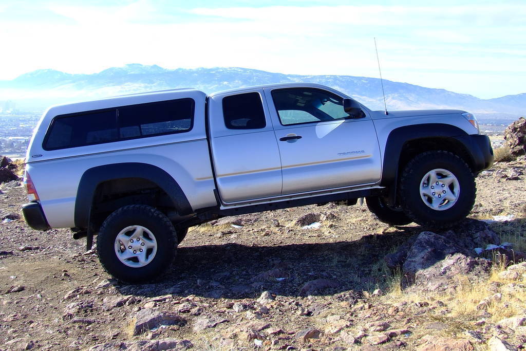

  20. Jan 20, 2013 at 10:45 AM
    #60
    4Wheelin4Banger
    4Wheelin4Banger [OP] Supercharged Toyman
    Jun 15, 2011
    #58306
    7,295
    Randy
    Ferntucky, NV Halfway between Reno & Falabama
    2011 4x4 Access Cab Supercharged Silver State Edition 245WHP
    3" OME lift 885s & Dakars riding on 33" KM2s
    I never measured mine but I think I get more than that. Rears alway flex more than fronts.
    Baby flexing
    My 4Banger AC is lighter than your V6 DCSB Pre which is why I get 3" from 885s.
