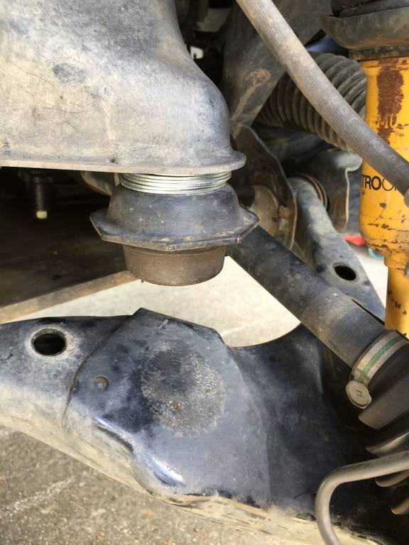

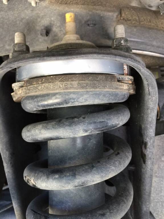

    if you put on a little top plate spacer (1/2" or less) just space out your bumpstops a bit - say 3/8"

    Just remember, if you're doing this:
    Also do this:
    If you can get a billet spacer instead of a stack of washers, so much the better. :cool:

    The nice thing about a small top plate is it gives you just a little more downtravel, which is nice when going over speedbumps and freeway expansion joints.
    You may have to tweak the upper control arm/ spring interference though. I'm having to do that.
    Or just go with 885s without a top plate. 2.5" lift, stock UCA, more downtravel, no top plate, no worries. ;-)

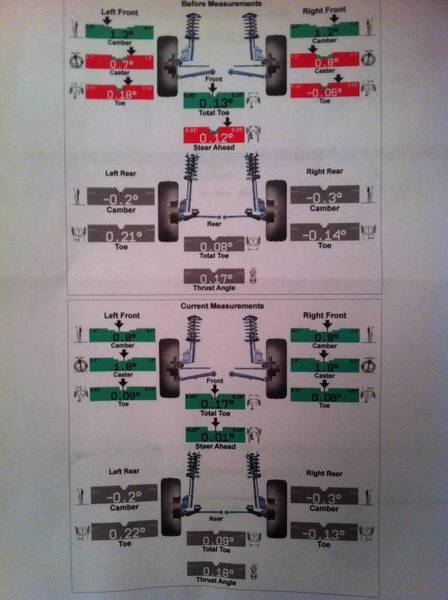

  15. Mar 18, 2015 at 9:34 AM
    #5995
    la0d0g
    Jan 25, 2011
    #49903
    19,882
    running for the hills
    For crawling not hauling
    I extended my brake lines all the way around prior to lifting but I'm pretty sure you can droop the rear suspension all the way and the stock brake lines will suffice.
    Some people get away with running stock UCAs but the general consensus is to get aftermarket UCAs to ensure proper alignment specs.
    The taco lean fix piece is called a trim packer and yes you want it as part of the assembly prior to installing.

    Alignment time! Light racing uca's, ome 3" w/ top plate spacers, dakars, 285s. Planning on telling the tech I want 0 toe, 0 camber, 2.4 caster. No cab mount chop and I currently don't rub with daily driving. I'd like to keep it that way. Anyone with this setup have better luck with different numbers?
