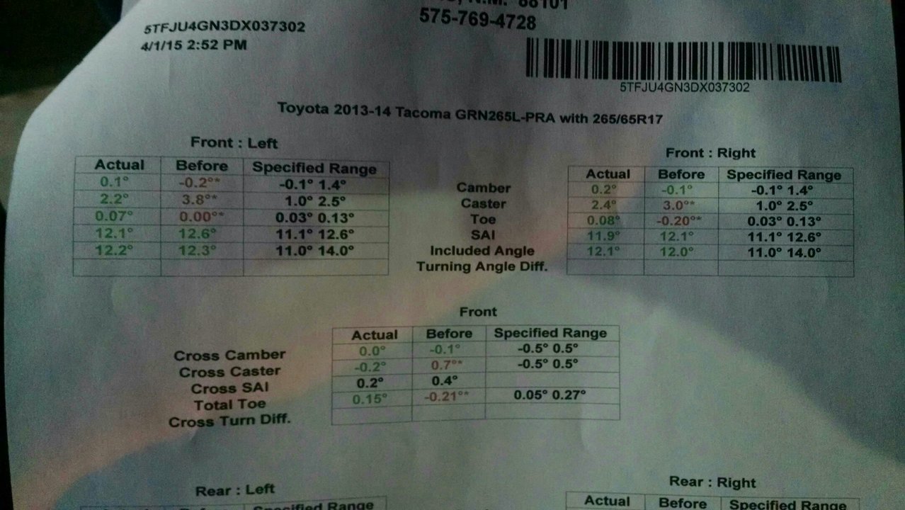

  16. Apr 2, 2015 at 6:25 PM
    #6136
    tacodane
    tacodane The Slow But Getting Somewhere Build
    May 25, 2013
    #104898
    4,902
    Dane
    2013 Tacoma Prerunner SR5
    Led Interior Lights AFE CAI Stage II, Aero Turbine 2525 Muffler Snugtop Cab-Hi shell TRS Retrofitted Headlights
    Got my alignment done yesterday. Here's my numbers. Have 885 coils with tc uca f0ba9ef369530ee91ab286327e2c62f8_b8a62de0cfcac400f32c710326624852b3e25de8.jpg
  17. Apr 3, 2015 at 7:48 AM
    #6137
    robertran88
    robertran88 TACOMG
    Apr 22, 2014
    #128271
    115
    R Tran
    Houston
    4x4 TRD Off Road
    Full OME Lift Kit w/Dakar Leaf Pack Light Racking UCA Method Wheels 17x8.5 Toyo Open Country RT Tires 30" Led Bar + 2 Led Pods w/CBI off Road Ditch Light Brackets sPOD Kit w/6 switch module Relentless Fab Hi-Lift HL-85 EGR In-Channel Window Visors Predator Step Bars HID 5000K
    do you have the print out? I would like to see the right adjustments to compare with mine
