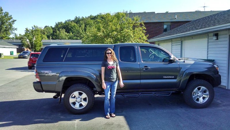

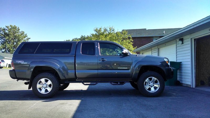

  7. Apr 10, 2015 at 3:51 AM
    #6207
    P33Rob
    P33Rob Well-Known Member
    Apr 30, 2013
    #103207
    201
    Rob
    Watertown, NY
    13 Tacoma V6 TRD 4X4
    OME 3" Lift; Maxfit aeromax; Volant CAI w/scoop; TRD Exhaust; Step rails; SCS stealth 6 wheels; Bedrug
    I have an 2013 ac with campertop and no armor. I installed the 885's they are a little stiff still but my lift is nearly 3" in the rear and 2.5 upfront. I just bought a spacer for the front to level it out. Also I have the SCS wheels 6. 285/70/17 going on this week in my photos the truck is lifted but on 265/70/17. Hope this helps

  9. Apr 10, 2015 at 6:02 AM
    #6209
    Acerwin
    Acerwin The unNORM NORM
    Nov 20, 2014
    #142732
    32,623
    Andrew
    South Carolina
    Toyota Tundra
    Thanks for the pics truck looks good by the way same color as mine.
