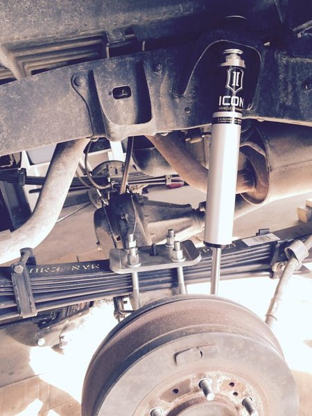

    Just installed Dakar leafs and Icon shocks. Removed 3rd leaf. Waiting for the suspension to settle to get measurements but off the bat I've already got 2 1/2" more droop than with stock leaf pack and 5100s. Very happy after my first test drive. Not too stiff not too soft it's just right.
