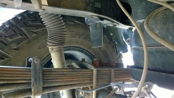

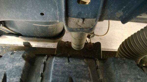

  4. Apr 13, 2015 at 10:34 AM
    #6244
    DMagoo147
    DMagoo147 Well-Known Member
    Oct 2, 2008
    #9630
    45
    Dan
    MA
    08 TRD OffRoad A/C
    CBI off road fab sliders with kickout, K&N performance air filter, BriteAssLED headlight bulbs, Delta Pro tool box, 20% window tints in front, 20% window tints added onto rear windows. Lou's Custom Exhaust: SS pipes and dual tip. LED backup lights. Prevent tailgate theft mod. Plastidip stock wheels, lower valence rear bumper and grill. bedside bottle opener. RAM-X phone mount. GTA car kits iphone/aux adapter.
    With the toytec u-bolt flip kit do you still need bump stops or is that not necessary because the dakars prevent the springs from compressing that far? I didn't see anyway to keep the stock bump stops on

  6. Apr 13, 2015 at 12:32 PM
    #6246
    la0d0g
    Jan 25, 2011
    #49903
    19,878
    running for the hills
    For crawling not hauling
    Yes, you'll want to run some bump stops. i put mine in from the top, went and flexed it and then cutoff the excess (these types of bumps were longer than I needed).

    Im thinking of doing the same setup i already have the icons just want to add the Dakars
    I was thinking removing one of the overloads
    Why did you decide to remove the 3rd leaf instead of overload??Post measurments when ya get a chance..:)

    I read a lot about removing the 3rd leaf or the overload. I picked the 3rd leaf because I usually haul 2 dirtbikes, a camper, and all the gear that comes with it. I understand that removing the 3rd leaf doesn't decrease the load capacity. Whether I'm right or wrong the ride is sweet. I'll measure later this week. Should have about 500 miles on it by then.

    cool i dont haul that much and really dont want to crank my coilovers too much and really dont want too much rake....a little is good...Im sure the ride has to be good my ride is alot better with the AAL but its starting to sag with only about 5k on them, time to move on...

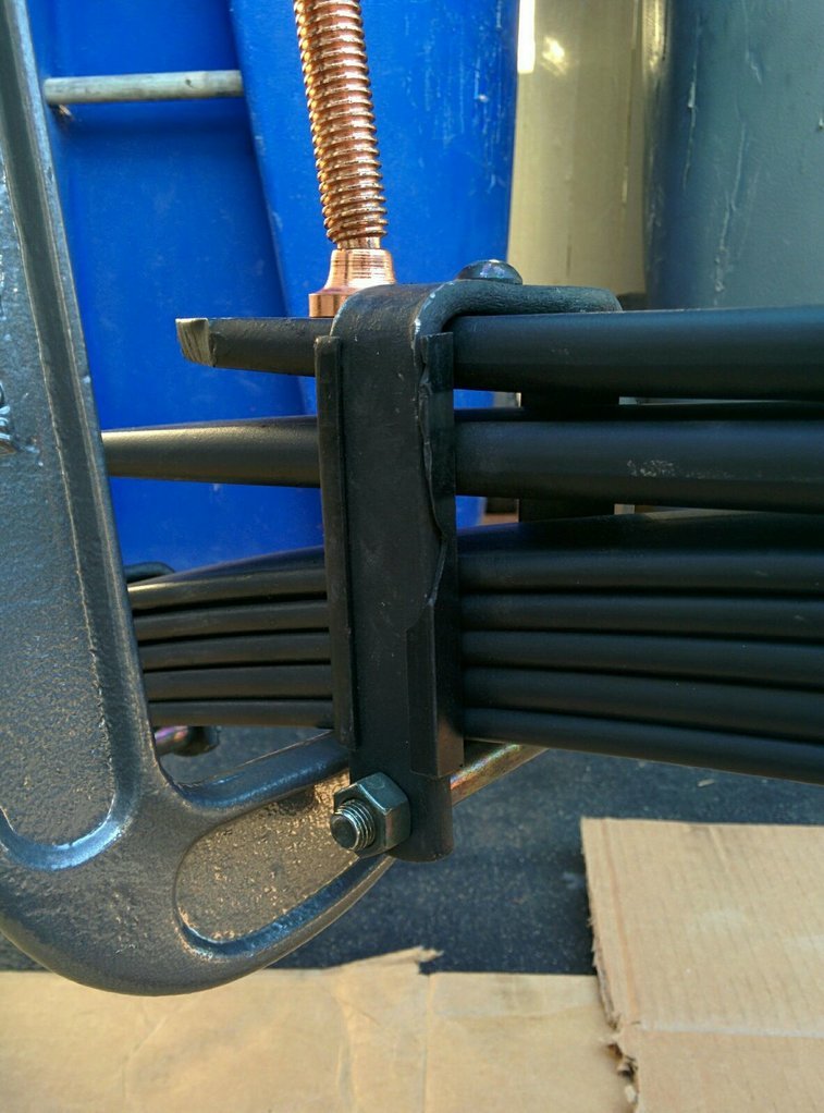

    oz are the overload and 3rd leaf the same thickness?
  17. Apr 13, 2015 at 7:06 PM
    #6257
    Crom
    Crom Super-Deluxe Member
    Jun 22, 2009
    #18782
    9,634
    Nick
    San Diego, CA
    2009 4x4 DCSB Camp Supreme
    Millions
    No they're different by a lot. See here:

    Forest Grove, Oregon
    I'm running the dakars with icon coilovers set at 2.5" and the ride is great IMO. The dakars are as nice as the stock 4 leaf springs that came off the drop. No complaints whatsoever.
    There is a bit of rake, but it's fine for me. The dakars lifted the rear about 2.75". Same rake as stock just more noticeable.
  20. Apr 13, 2015 at 9:28 PM
    #6260
    OZ-T
    OZ-T I hate my neighbour
    Dec 15, 2009
    #27584
    50,582
    Peter North
    British Columbia
    No , the overload is thicker , why ?
