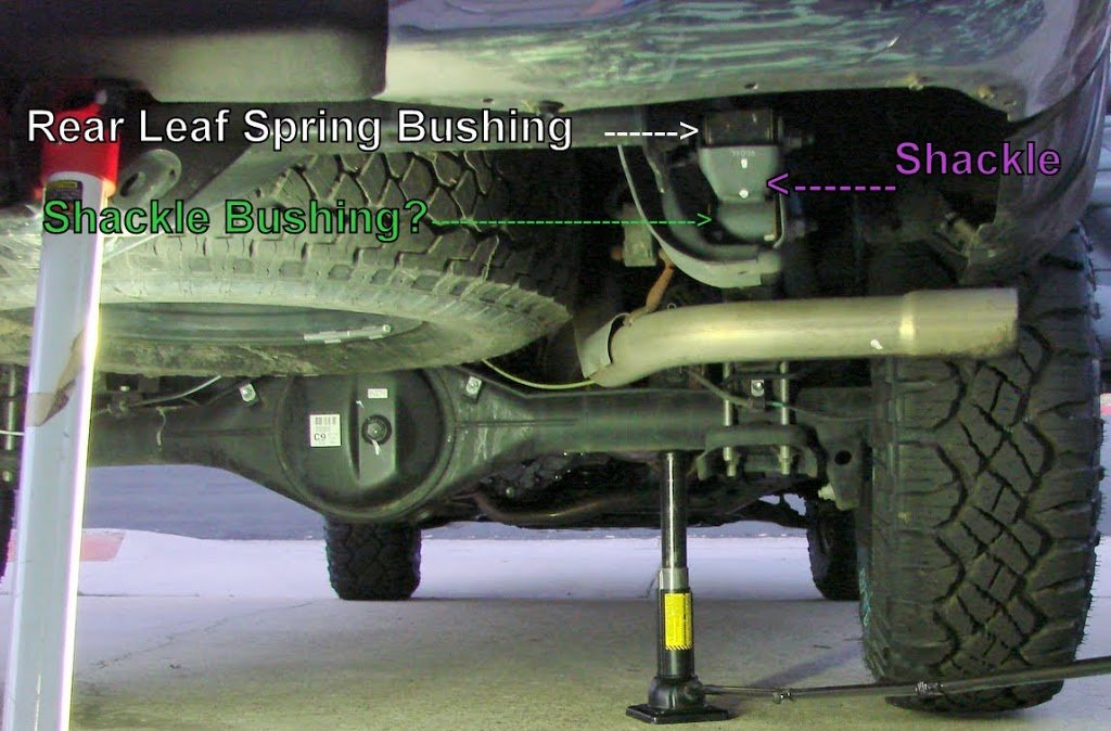

    When installing the Dakar leaf pack, did any of you bother to replace the shackle bushing at the same time? I'm trying to understand if the shackle bushing is the exact same size as the bushing that goes in the rear spring eye. This is proving to be a pain in the ass to find the answer to. I eyeballed it and I can't tell. I looked at a Toyota parts diagram and it seems to point to the same part number but I am not sure.

    My Dakars included all bushings that I replaced. Four of them were already in the leaf packs themselves. The rest of the parts I reused.

    No but have a look at the greaseable shackles by Defined Engineering

    He's not asking about the leaf pack bushings , he means the ones in the shackle

    So in other words you just kept the Toyota stock shackle bushing as is.
    I want to replace mine now while I am doing the work of installing the Dakars.
    Energy Suspension sells a kit (Part# 8.2116R) for our trucks to replace the spring eye bushings and the shackle bushings, so its (6) total bushing sets. But I can't for the life of me figure out if they are all the same size bushings or, are the shackle bushings smaller than the spring eye bushings.

    I appreciate the responses. Okay. I called wheelers and they said that On 2nd Gens, the shackle bushing is the same size at the Toyota stock leaf spring eye bushing which is 60mm.
    Basically what I want is half of this kit that they sell: What they said matches the results of the Toyota diagram I read which showed both bushings having the same order part number.
