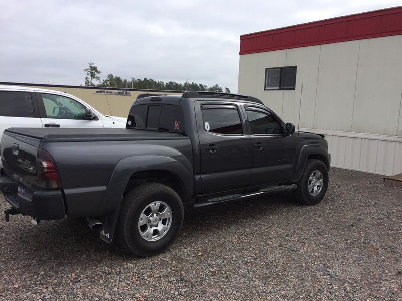

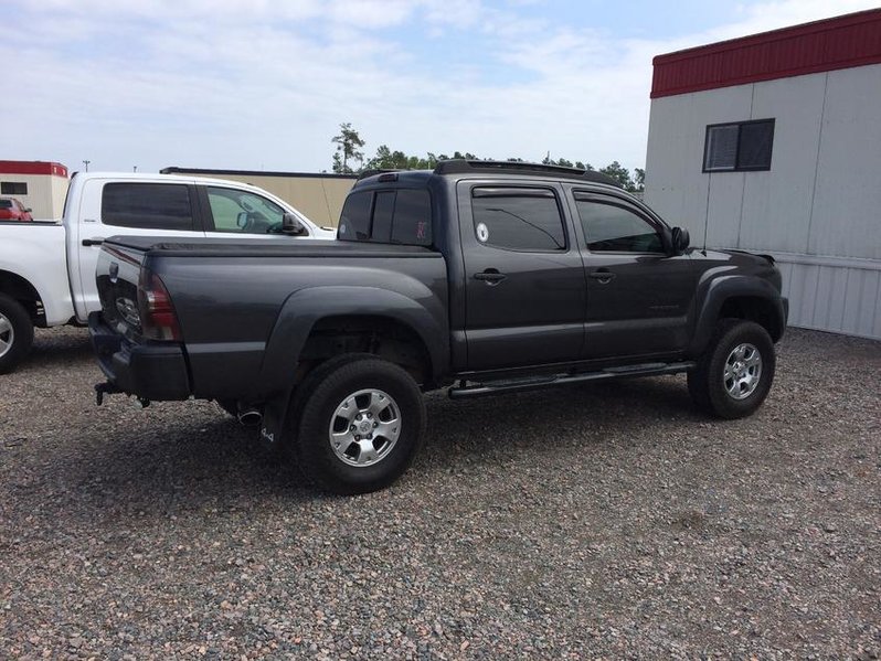

  14. Apr 21, 2015 at 12:29 PM
    #6394
    EBORSETI22
    EBORSETI22 Well-Known Member
    Mar 17, 2013
    #99882
    271
    Evan
    New England
    '11 TRD Offroad
    TRD Exhaust Bed Mat Tinted Windows Tonneau Cover Cubby Bed Lights Reverse Lights Anytime Fog Mod Full OME Lift - 887s, LR UCAs, Dakars with D29XXL AAL MB TKO 17" Wheels 255/80r17 ST Maxx CMC Volant CAI with Scoop NFab Running Boards "Raptor" Grille Lights Ditch Lights 30" LED Hidden Light Bar On Board Air
    Before:
    After:
    What did you put up front & what did you get?
    887s with driver side trim packer and 1/4" top plate spacer:
    Driver Side:
    Before: N/A After: 23 7/8"
    Passenger:
    What did you put in back & what did you get?
    Dakars with D29XL AAL
    Driver Side:
    Before: N/A After: 25 1/4"
    Passenger:
    If you got Dakars on a 2nd Gen share your measurements with OZ:
    Done.
    Are you running trail armor & how much lift did you lose or what did you do to regain/maintain lift?
    Not running any armor.
    Tire & wheel specs & rub or what you did to eliminate rub.
    Toyo Open Country AT2s
    265/75/R16
    Stock TRD OffRoad Wheels with SpiderTrax 1.25" Wheel Spacers
    Had minor rubbing with no lift on the mud flaps, so I removed them.
    With no mud flaps and the lift I have no rubbing, but I plan to install Husky Front Mud Flaps and see if I have any rubbing.
    Had some vibrations at about 7-10mph, but installed the drive shaft spacer that OME includes with their lift and it eliminated it. Rides great now.
    Are you still running a sway bar?
    No.

    What made you decide to go with 887s and the 1/4" top plate? Seems like you would be sitting close to 4" of lift.
    Any plans for armor?

    From what I read about the 885s, everyone was using the 1/2" top plate spacer to get the full 3" and the 1/4" to remove the driver side lean. With the 887, you get the 3" lift without the additional spacer on the passenger side, but I did still need to correct the lean, as the trim packer was not enough.
    No plans for armor now as it's my DD and I don't do too much offroading.
