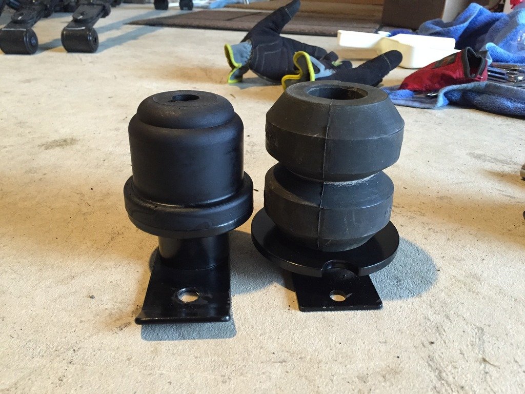

    Just FYI I installed dakars on my 15 DCLB and got 2.75" lift, compared to my still brand new 4 spring leaf pack. With an empty bed I still have a lot of rake with my front icons at 2.5" lift. You'll want to remove a spring from the leaf pack if you insist on being level.

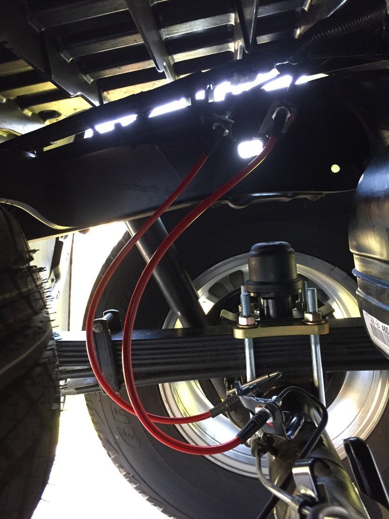

    Brake lines are needed with longer rear shocks. The OME rear shocks are slightly longer than stock but likely short enough to prevent over extended brake lines. Unfortunately your new leaf back will support longer shocks, and your shocks will be the limiting factor at (I think) roughly 24". Just going off of memory. you probably won't notice for the most part, but just be aware that if you air the truck out or something, the shocks are going to want to pull apart.
    You do realize that a 3/4" top spacer is going to allow the front end to droop about 1.5" more than OME intended too right? Your upper arms may be fine but you may be destroy CV joints at full droop.
    The caps for the icon uniballs need to be ordered separate IF you want them. I went with Icon uppers, but other brands may have a better uniball with a couple more degrees of misalignment.
    Also if you decide you would rather have superbumps in the rear instead of timbrens, just buy all pros u bolt flip with drilled top plate and bolt. The super bumps on wheelers bracket can be drilled and mount in the same place. Just another option.
    Allpro's timbren and bracket vs wheelers superbump. The timbren compresses 2 1/4" according to their documentation, fyi.

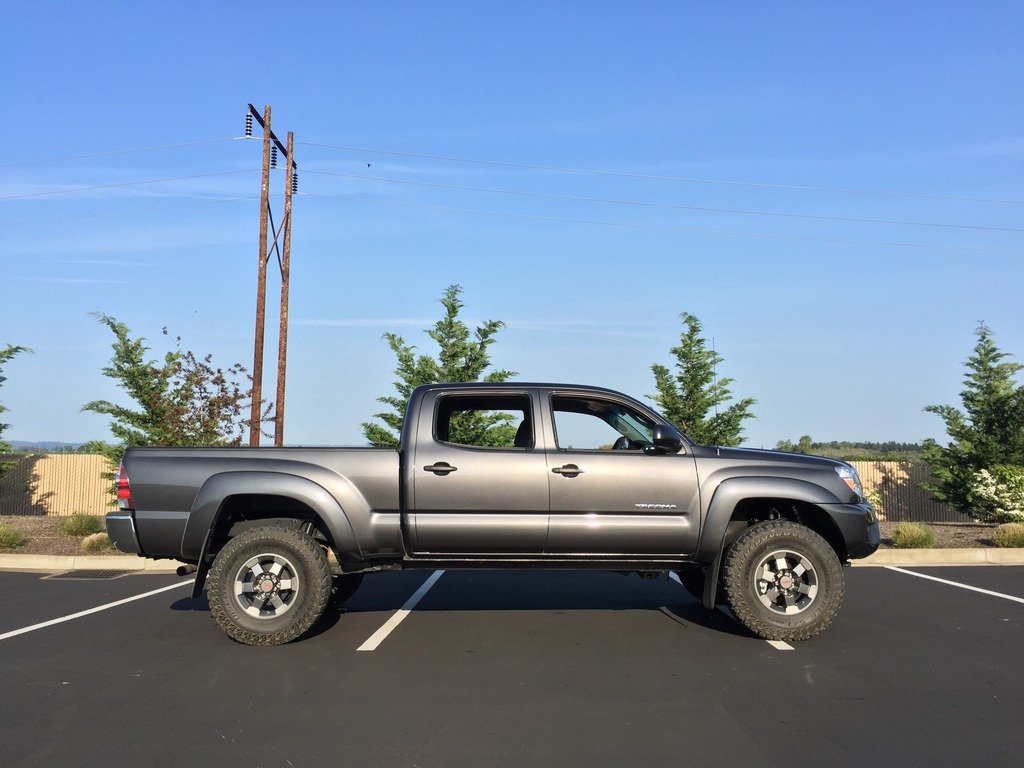

    You can remove a spring from the leaf. I think (don't quote me) the 3rd down is recommended for a softer ride and lower height. Or you can pull the top overload for a drop in height without changing the ride. The timbrens will be your overload anyway.
    Here is my truck with the front adjusted to 2.5" lift, with the Dakars, at least 150lb in the bed and an 80ish pound spare wheel/tire.
