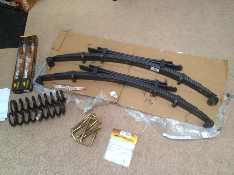

    Finally all of my kit has arrived! Unfortunately it may be a month before it's installed. With working on weekends and other reasons I just don't have the time yet. Oh well.. Oh and I since ya'll have informed me about tire sizes with this lift, do any of you know what the largest size that will fit in the spare tire spot under the bed? Can you stuff a 285 in there?

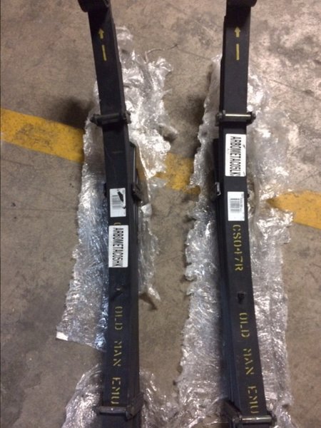

    guys... Got a question... I'm about to install these... But both of them have the - sign... Is it ok? I know that the driver side should have the + sign... Thanks!! Chepo

    It's fine

    Can you guys tell me what the + and - symbols mean? I thought both driver/passenger had '+' symbols..

    + is slightly above spec , - is slightly below spec

    The + and - is a tolerance thing and really for the manufacturer. 0 is at the spec, + is just over (more lift), and - is just under (less lift). These markings are not really meant for the consumers but ARB revealed what they mean so we might as well use them to our advantage to help correct the lean.
