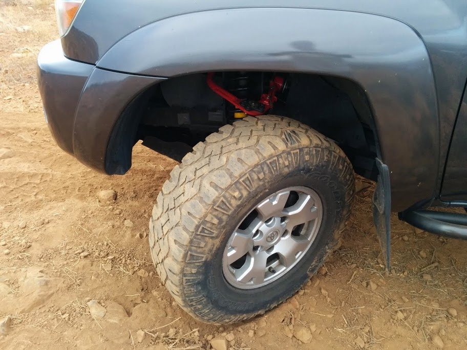

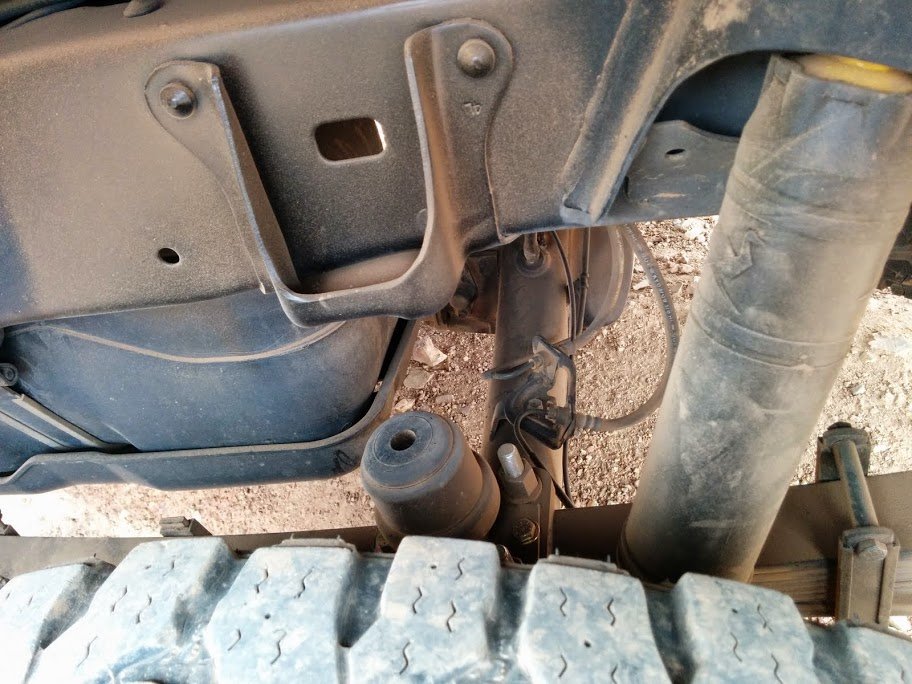

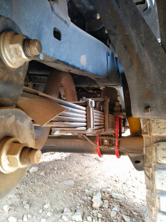

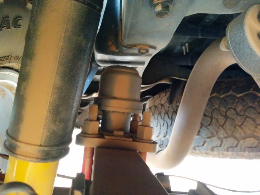

    I really like my Dakar leaf packs. I have some pics to share.

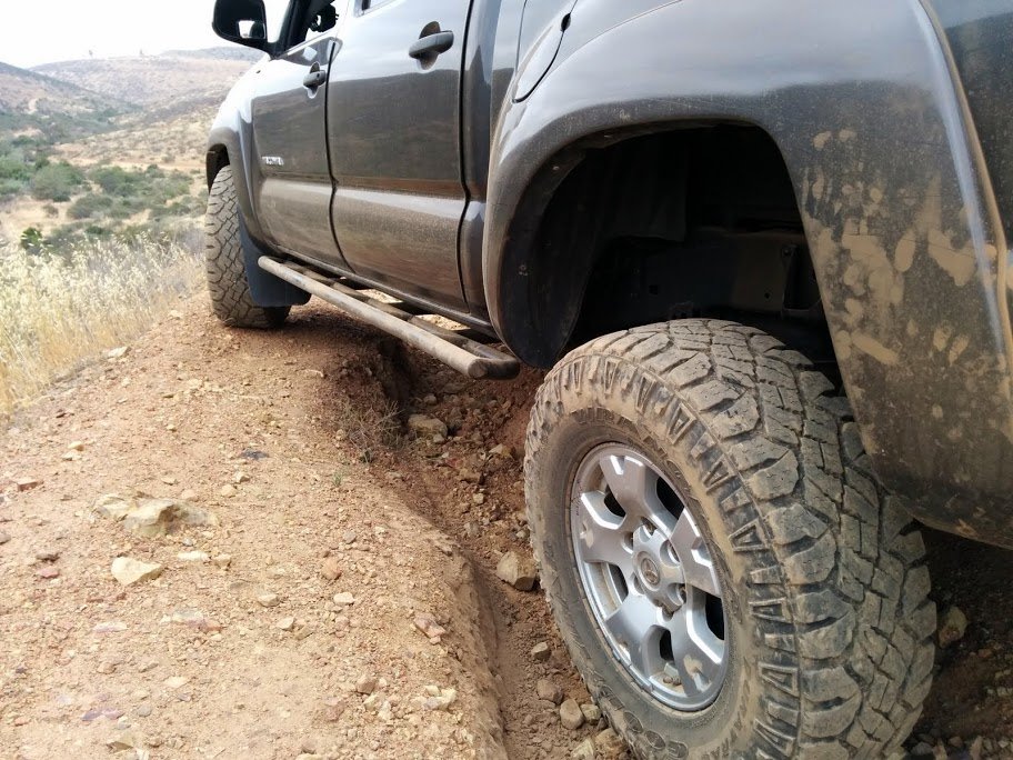

    Truck has 300lbs over stock in the bed. Dakar leaf pack has overload removed, and D29XL AAL installed, plus a 3* axle shim. The OME shocks limit axle droop by about 2", this was discovered during install. If I ran longer shocks I could get more droop out of the rear, but I'm just fine for where it's at right now. Other thing to note was that I had to pry open the lower shock mount on the axle housing to fit the OME shocks. :(
    On road it rides excellent, and I'm very happy with off road performance.
    My tires are old and beat, sized: LT265/75/R16
    Driver side flex, not quite maxed out, but close
    Drivers side:
    Pass side with 1/4" until bump stop.
    Pass. side spring pack
    Shiny and new on install day

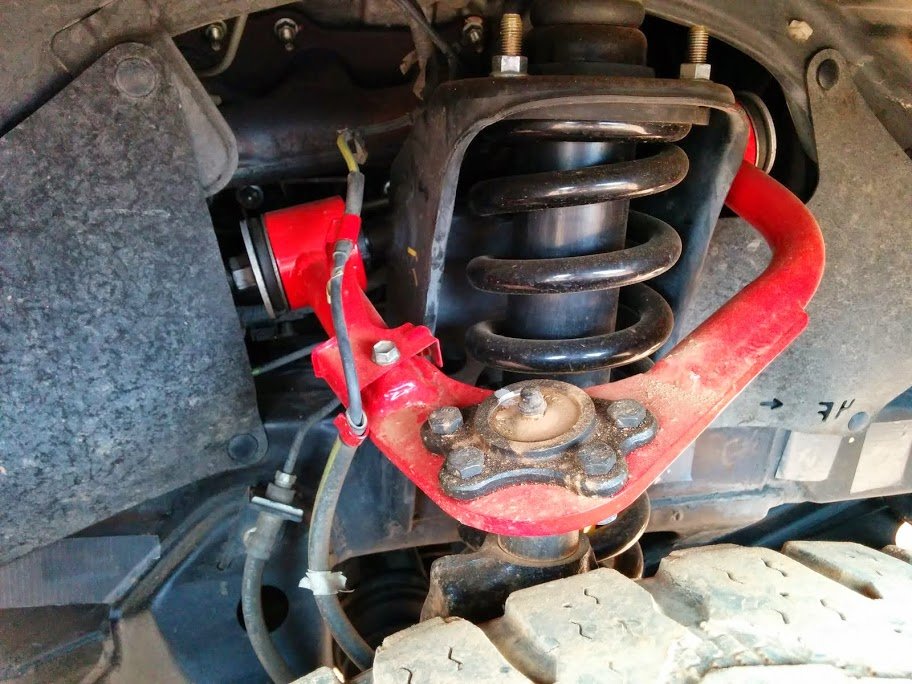

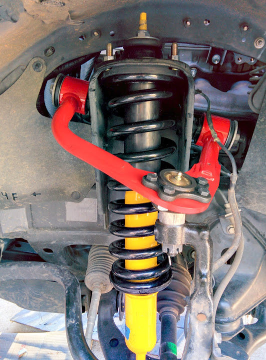

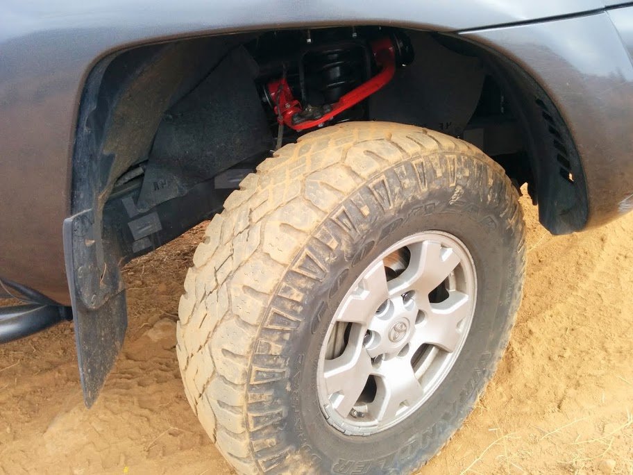

    Here are some of the front, OME 885 coils 921 shocks. Sorry not the best pics.
    New on install day
