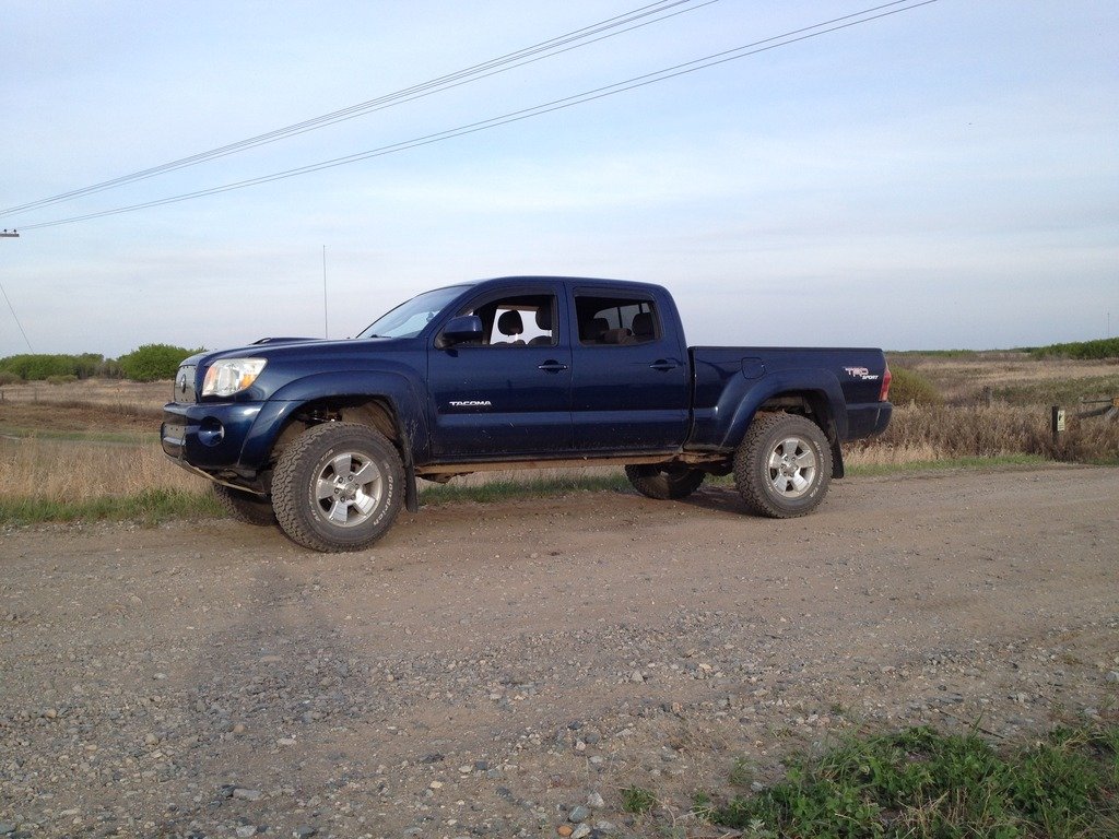

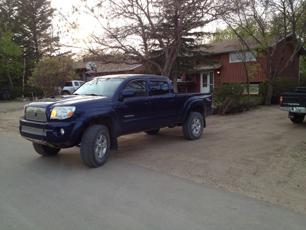

    Yea I'd say it's pretty level right now, that second photo I posted was on pretty level ground and it looks pretty level from the front to the back. As for measurements I seem to have already misplaced the paper with my measurements from when the truck was stock, had spacers, went to 33's with spacers, and now with 33's and OME. I'll keep my eyes peeled for it though. I'll also try to find a nice level spot to get a few more photos, our driveway is dirt and the road in front isn't completely level.
    The ride is solid, I've only hit a few dirt roads so far, but I'm very pleased at the moment. The OME setup feels good all around. I'm really happy I went with the 887's, truck looks nice and level now with the 2" add-a-leaf in the rear. You also shouldn't have any sag with an aluminum bumper, should come out looking really good!

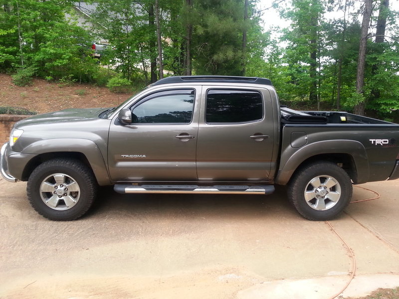

    I'm a 2012 TRD Sport DCSB 4x4 and just got my OME 887's, 90021's, CS047R Dakar and 60091 , and LR UCA's installed last weekend. Got 2.75 lift all around. I did have to add 1/4 in top plate and trim pack for driver side lean.
    Here is before:
    and after:
    I'm very pleased with the ride!

    Wow, big difference in height! Is it super stiff from prior?
  11. May 21, 2015 at 6:14 AM
    #6531
    jazzbone96
    jazzbone96 Well-Known Member
    Mar 23, 2012
    #75429
    165
    John
    Fayettville, Ga
    12 Sport 4x4
    OME 3" lift, Dakars, Nitrocharger struts, Wheeler's super bump stops, redline struts, oem roofrack, fog light mod, sockmonkey decals, TRD shiftknob
    Actually no. With the 90021's i feel like it is a lot smoother. I drive a lot of rough back roads to work and the truck seems to just glide over the roughest areas. I should also mention that i did wheelers super bumps front and back as well.
