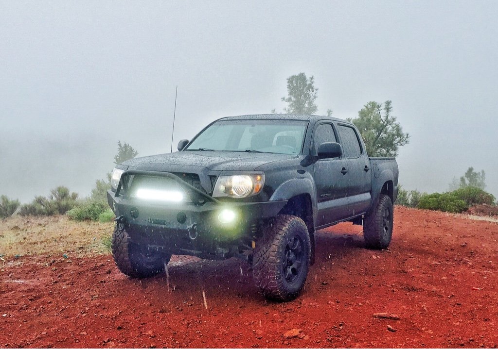

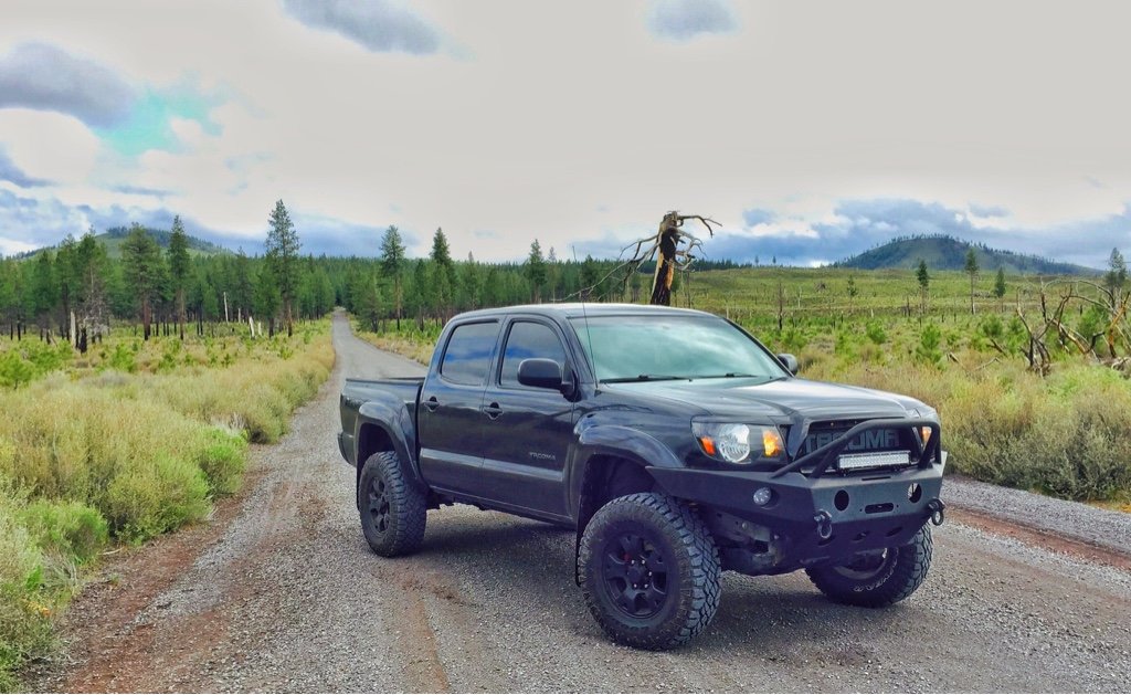

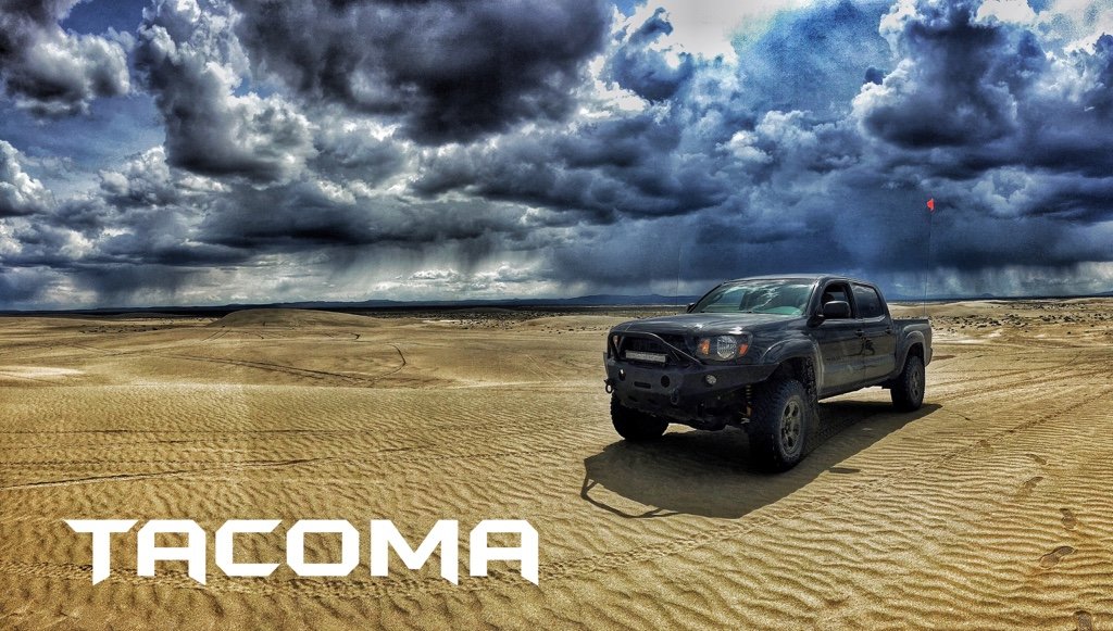

    It's been a a little over a month and I love my ome lift.. Truck looks sexy and it handles everything I throw at it. Only knock on it is I can't really tell a difference in road driving plus I need to replace my needle bearing now cause I am getting vibrations in 2wd.
