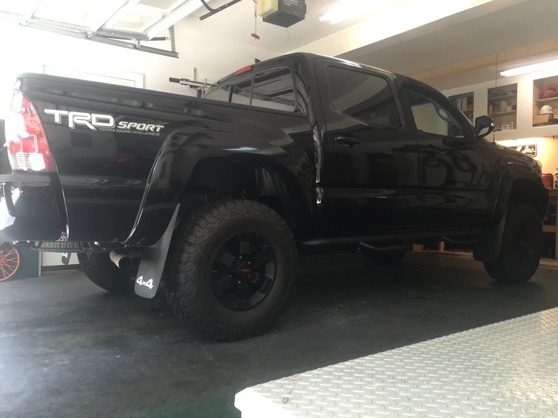

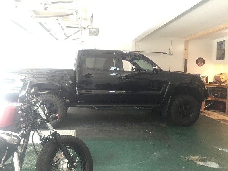

    Blacked Out-887-Dakars-LR UCA-FJ Trail Team wheels-285 BFG KO2
    Just finished installing my 887s, dakars, and LR UCAs... FINALLY!!! Lift has been sitting in my garage for at least 6 weeks!
    Me and my GF's brother knocked it out in about 4 hours... He's a mechanic with air tools in his garage. Huge timesaver for sure.
    Only real issue we had was the rear driverside lower shock bolt didn't want to line up... Took a little finessing with the BFH haha!
    Need to take measurements on the rear still, but front is right around 3.5". No alignment yet, but I hit 65 mph and it felt fine... And only a little shudder under 10-15 mph.
    I'll get some better pics and rear lift numbers after work...
