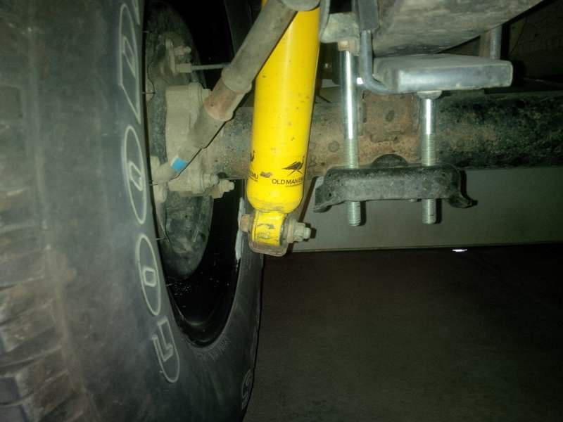

    Did anyone have fit issues with the 60091 shocks fitting into the lower mount in the rear? On both sides it was extremely tight and had to bend the mounting bracket out a bit. Still did no go in smooth. Seemed like the bushings on the lower shock eye were protruding out more than they should, comparing to stock.
    When the truck is on jacks and no pressure on leafs, with the top of the shock out of the mount I can still move it back and forth with some force as the bushing intended. How freely should it pivot in the lower mount?
    Trying to trouble shoot some possible rear issues with bushings being too tight on the shocks, shackles, and leaf springs causing a stiffer ride than intended.
    I know there are fit issues with 2015's and these shocks, but didn't think there would be for my 2009.
