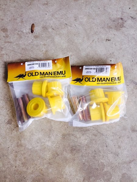

    Got a question about the center threads on my ome 885 fronts. Should the treads be the same length, see picture, or should they be like this because of the trim packer on the one showing less threads? I got these pre assemble and this is the way they came.
    I've had my OME 885's and dakars since Decembers. And I've since traded in my '11 on a 2015. Are there any issues other than the rear shocks with the 15's?

    I also got 2 sets of Dakar bushings with my kit. Did I get an extra or should I swap out the ones that came installed in the front of the Dakars?

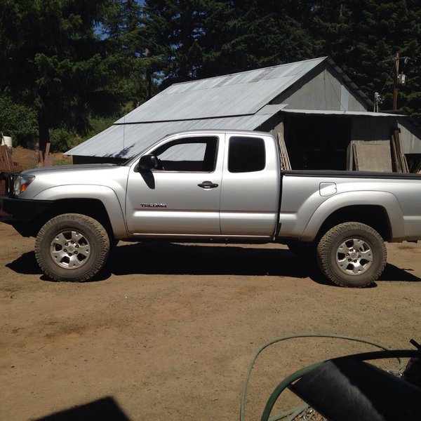

    Just finished my Ome lift with General springs instead of dakers. Extremely happy with the height and drivability. image.jpg

    Ome 885 springs/nitro shocks 90021, no spacer. Trim packer for the drivers side.
    LR UCA's
    General springs HD leaf spring pack for the rear and Ome nitro shocks.
    Day of lift I got,
    Left front 23.25
    Right front 23.5
    Left rear 24.25
    Right rear 24.5
    Figuring stock hieght is 20.5 front and 22 rear.(my stock shitty shit was a bit lower then that). That's a clean 3 inches in the front and 2.5 in the rear. Should settle atleast 1/2 in I figure to the desired hieght. Ride is great on and off road. so far very happy. Took myself with the girlfriend helping hand tools and what not 8 hours to complete.
